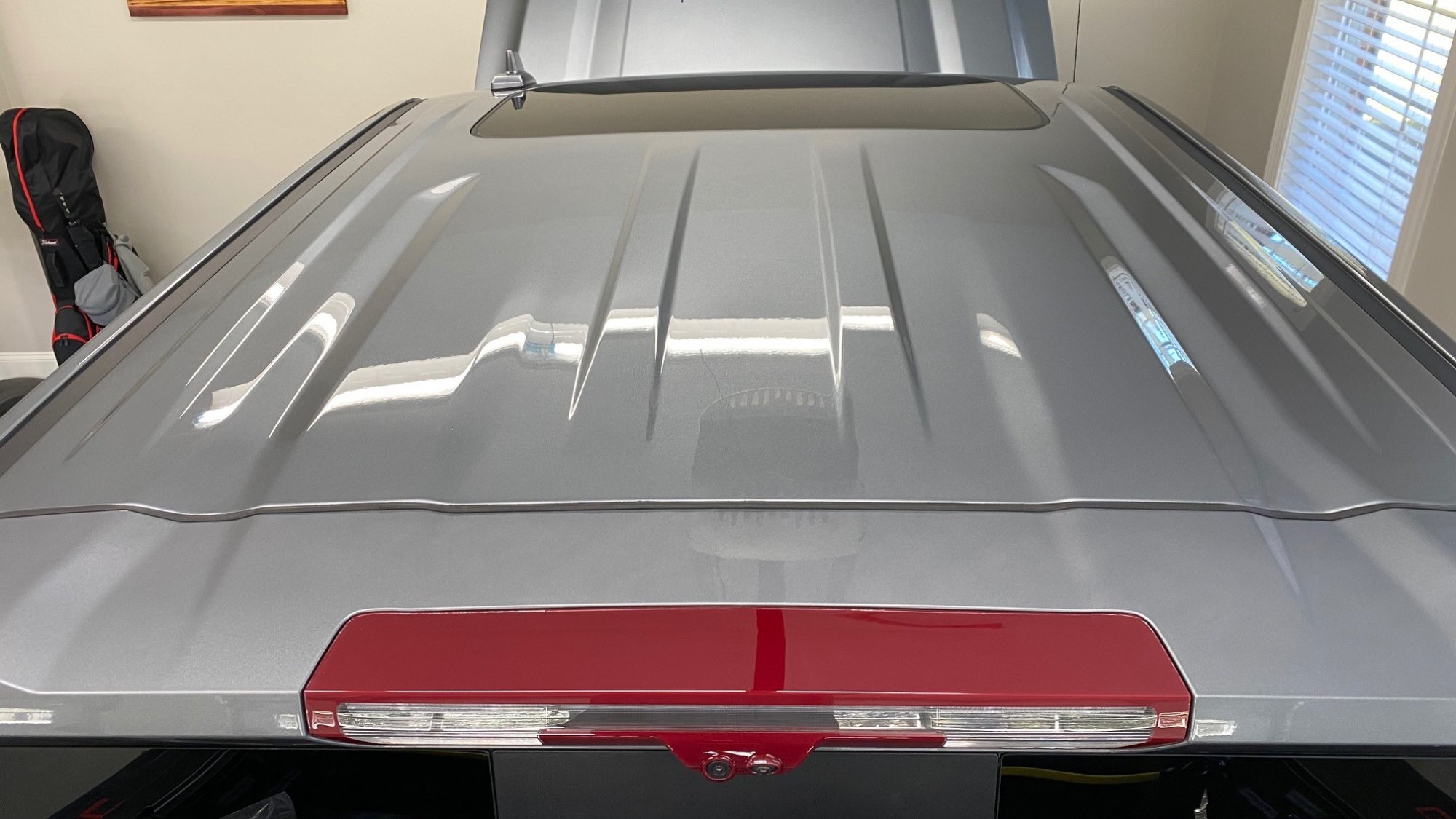

8 hours ago, Kclyatt said:
Update....Few months into sealing my rear glass and happy to report no further leaks. I recently sealed up my spoiler as a added guarantee because as we can see GM does not have our best interests in mind. I used door trim from Lowes and this particular type has ridges to help with the trim tool to push into the tight space and also has adhesive on the back to hold into place once set. The third brake light I used clear silicone (same type 3M) since that gap was too tight for trim.
Hope my enthusiasm to prevent future leaks helps another in this exclusive club of leakers!
What trim did you buy from Lowe’s? Does it have glue on the back side? If so did the backing stay on until you had everything in place?
I used this and peeled back the strip covering the adhesive side slightly and once tucked in I then pulled the strip and used trim tool to even out all areas.

This seal should finally put the leak issue to behind me and this is the same I used on top with the spoiler/cab gap. Seal gives water no chance to run down spoiler and sit on top of the window trim which develops cracks and allows water in. I could use warranty but (after 204 pages currently of leaks) the warranty is about 50/50 on correcting this issue and for me this is easily reversible if it doesn't work.
All in $16 total for 3M silicone (sealed window and 3rd brake light) and one roll of the marine seal. Total time of 15 minutes and 1 day cure for the silicone and approx. 45 minutes for the seal which seems like a fair trade vs. going the dealership route and getting frustrated, crappy work, lost time, etc.!

This is zoomed in pretty far so can't tell what I'm looking at.  Is that the 3M silicone or the marine seal or both?  Is that the top of the window (assume so)?  Where all did you put the marine seal, specifically?  Thanks in advance.

Both....This is a seal between the spoiler  bottom edge and the window gap. I already applied silicone on top just like the TSB the dealership would have done except I did not remove the spoiler. I cut the tip of the 3M silicone tube (I used 2 total/small one not the caulk gun type) and laid the bead above the window frame 4 months ago (still leak free) and this is just an extra precaution. I felt the need to eliminate any water getting to the window seam would be best for long term.
I also applied the same marine seal on the roof between the cab and the spoiler ( see my previous post page 203). I know my work and it's satisfying to know that given time and some care you can seal your window up and save the hassle of warranty work mistakes and damage.
This is all I can see from my repair

Can you show what you did at the ends of the spoiler driver or passenger side is fine?  The spoiler gap does a 90 degree to towards the back.
