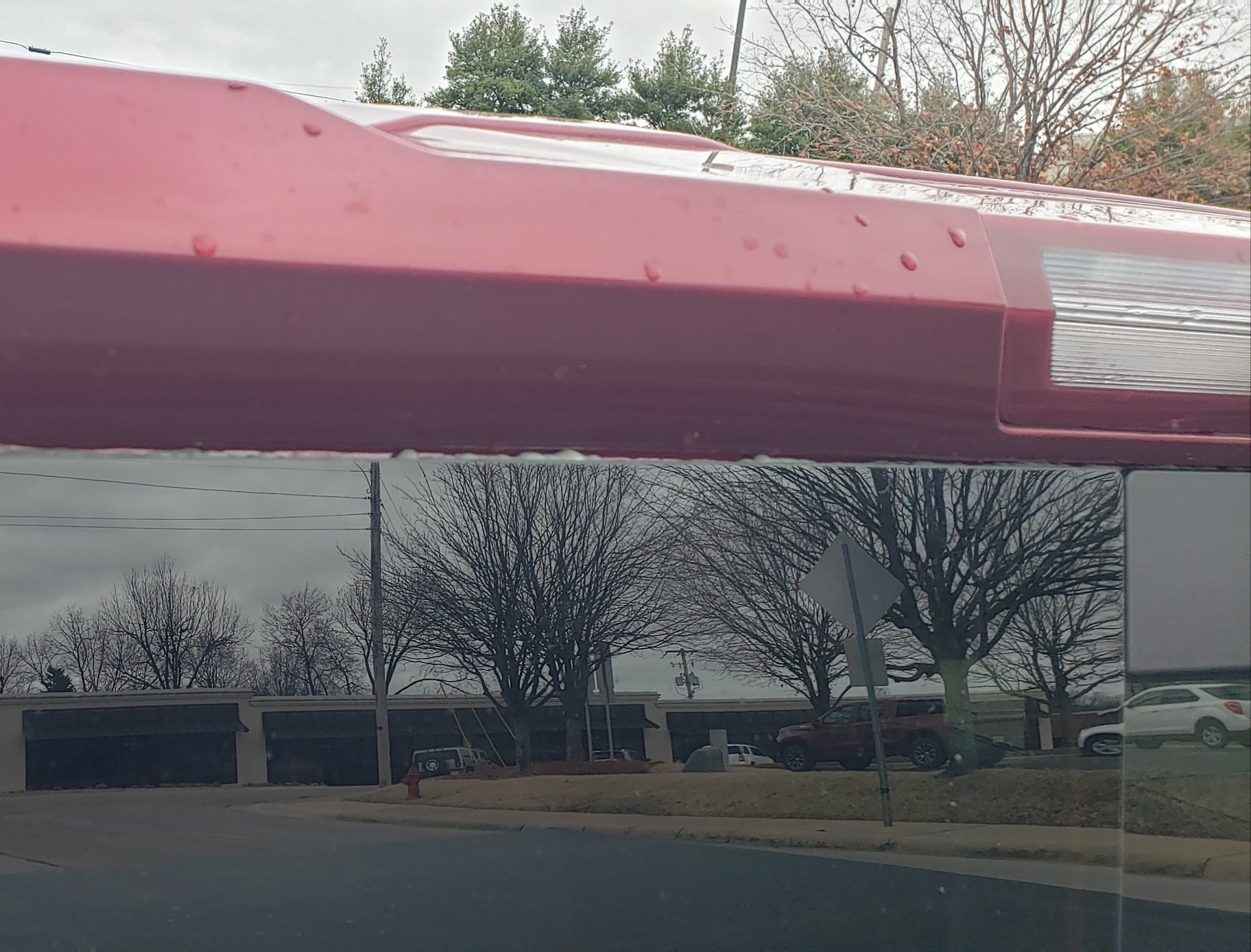

28 minutes ago, BamaBen said:
This is after 4 repair attempts.  This is just rain.
I almost feeling like calling gm or your dealers service department and bitching them out for you, that is disgraceful and no excuse for it imo!
If GM can't fix your truck they owe you a new one imo! Maybe ask them to give you the non slider back window, the sliders are the problem in these trucks imo!
That is atrocious! And after 4 "repair" attempts? Good heavens. So sorry, BamaBen. 😕
Not claiming to be an expert but fairly sure that’s caused by the yellow retainer gasket on the spoiler.   Bad gasket.   Can be easily replaced.
Unacceptable that this is happening to you.  Looks terrible.
This is the 4th time they fixed it, and last time the over torqued his spoiler bolts. It’s back a page or two, but he explained it all.
At least that what they told me...  funny how the maintenance records on my.gm.com are not filled in for the last 2 service visits.
The count currently is 3 fixes of the spoiler gaskets and 1 reseal of the rear window.  I'm not giving them the chance to repair it again.  Lawyers are on it.
