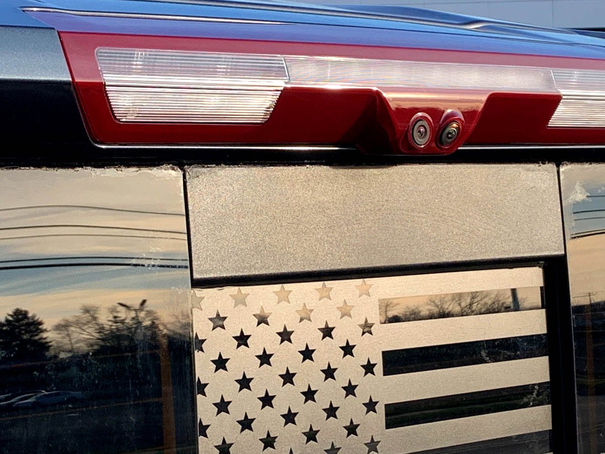

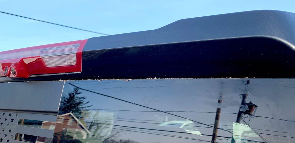

Picked mine up for the rear window leak fix this evening, there's so much sealant balled up in the gap between the top of the rear window and spoiler, and smeared on the window/spoiler I hope there was still some left to fix the actual leak!.    Talk about piss poor workmanship.
Did they remove the top trim piece with the center mounted brake light, or just inject sealer between the plastic spoiler and glass? Then try and clean it up afterwards.
Yeah they did remove it, you can see inside on the seatbelt slot panel and all the blue crumbs (headliner insulation maybe?) inside on the back seats they were definitely inside messing around.  Thankfully they didn't wreck anything inside.

Yep, first time they try the sealant gimmick, if that doesn't work they evidently replace the rear window, which is what should be done the first time.   2021 owners are reporting the issue as well on the facebook groups, both US and Mexico made trucks.   I'm sure it's cheaper for GM to pay a tech $15/hr and $13 for a tube of Kent sealant and hope it works at least long enough that you get beyond 3yr/36,000, then the correct fix is on your dime.  Enough guys report that the sealant fix either doesn't work, or only works for awhile that it's clearly a bandaid fix.
It IS kind of a bandaid.....HOWEVER:  If you take the time and do it with with the Kent Hi Tech Clear sealer,  it should last a LONG time.
Kent is great stuff.   But you have to either be familiar with it as I am, or take a little extra time to "get it right" ....take a window tool (or even your little finger in a latex glove) and "work it around" to make sure it covers all the potential leak spots.
IF you do that, they don't come back.   I've not had a single one come back from leaking at the top of the glass where that plastic piece cracked beneath it.
The TSB does say that they only "suggested" the Kent and other products might work.  I think that's where you might get into trouble, if someone tries to use silicone or something else inappropriate.   They might work, but they sure as hell won't look as good, as the awful pics a few posts behind this one indicate.  That is TURRIBLE workmanship right there.   I can't believe anyone let that go back to the customer like that.
I highly recommend the Kent sealer for this.  Once you put it in there, it "flows out" a bit and has a nice, shiny finish to it.   Looks far better for those eagle eye folks who want to get up next to the gap and see what was done.
The other thing is, the TSB only pays 1.9 hrs.   I can beat that time, but you have to be humping to do it, and this is what I do.  I can beat the time and you can't tell I've been there, other than your truck doesn't leak anymore...or if you stick your eye up to the gap between the window and spoiler and see the sealer.
A tech in the shop who only does one here and there, he's probably not going to be able to beat the time, and not going to be happy about it, and that can affect workmanship.   YMMV, as always, but it varies more with many different techs doing the same repair than if you use a specialist or glass company.
