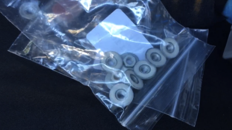

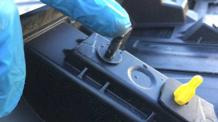

The TSB tells you to replace all those nuts.  Reason is, that white sealer that's applied to them.  Not much of it left after removing them.   There's 8 of them, and unless something's changed they come in 8 individual little bags.  What a pain.
I replaced them the first few times, but I don't bother now, I just put a little bit of 3M 08612 butyl on the stud and that's better than that white stuff, anyway.  And I don't need to do go the parts department to get the nuts AND return the old ones, as warranty requires.
There's also 2 10mm bolts (or screws if you prefer) on the outer part, but still inside the cab.  So 8 studs sticking through from the outside, and 4 screws sticking through from the inside.  Plus a couple more alignment clips and IIRC one more alignment stud as well.
