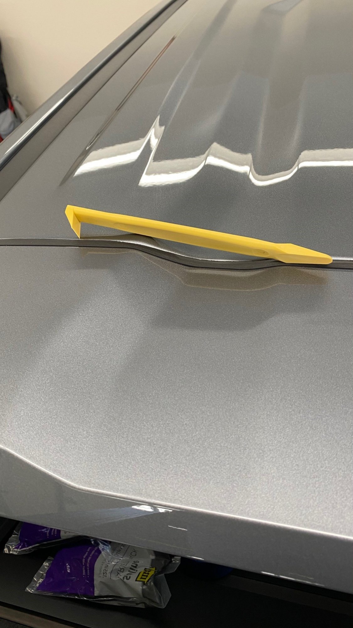

On 2/24/2021 at 12:52 PM, Kclyatt said:
Update....Few months into sealing my rear glass and happy to report no further leaks. I recently sealed up my spoiler as a added guarantee because as we can see GM does not have our best interests in mind. I used door trim from Lowes and this particular type has ridges to help with the trim tool to push into the tight space and also has adhesive on the back to hold into place once set. The third brake light I used clear silicone (same type 3M) since that gap was too tight for trim.
Hope my enthusiasm to prevent future leaks helps another in this exclusive club of leakers!

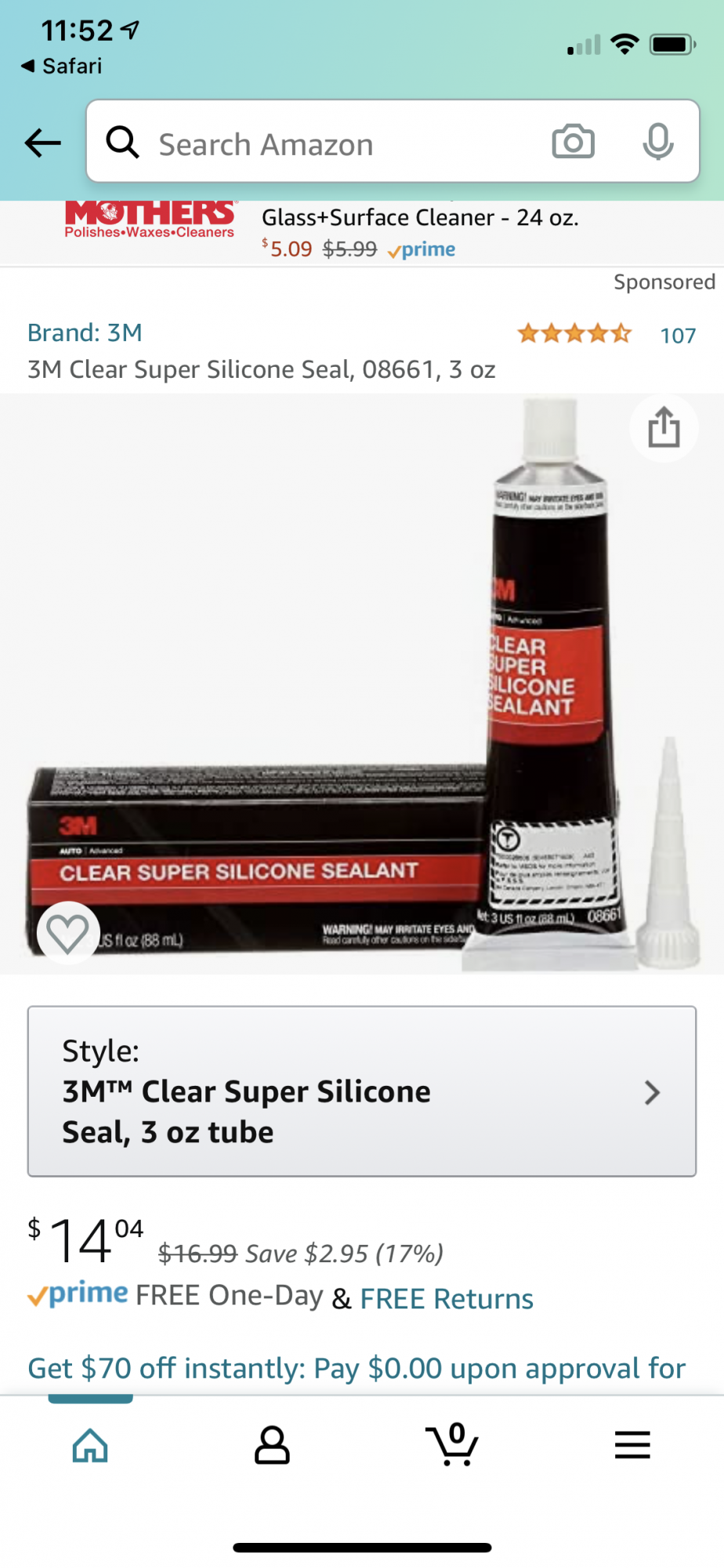

Thank you for sharing this. Can you advise what 3m silicone you used and possibly provide a link?
Thanks again,
JMF

28 minutes ago, Kclyatt said:
Thank you very much for your assistance.
JMF
