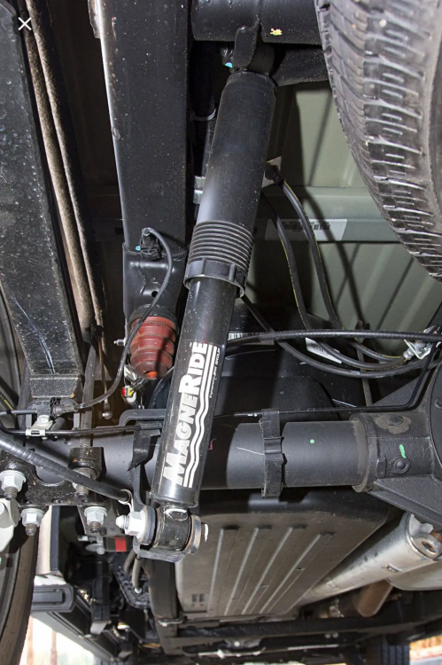

I just bought a 14 sierra denali a few weeks ago, I assumed it had the magneride suspension but looking at the struts I believe it's just the standard suspension. I did some reading and it sounds GM didn't introduce the magneride until the 2015 model on the denali, is this correct?
There's nothing on the original window sticker that says anything about the magneride, honestly I'm hoping it's just the standard suspension as I plan to lift the truck and there's not a lot of options with the magnetic ride.
On my front strut the part number is OE: 18644 23106627
Looking up the Magneride part number it looks like it's 23151115
Again, just looking for confirmation. How is it that not even the dealership can tell me what suspension I have? Everything is pointing to the standard struts but the two look very similar.
