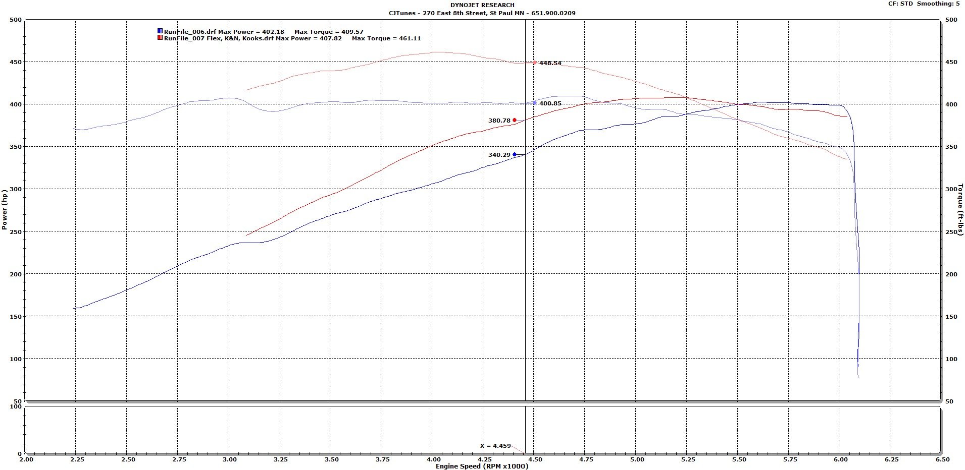

Blue is mine with Afe Cai, ported stock tb, ported MSD intake manifold, 1 7/8" headers with high flow cats, stock cat back, and e85.   Red is stock L86 intake and tb with 1 3/4" headers, high flow cats, and a cat back.  Now have ported L86 intake and ported LT5 tb on it.
