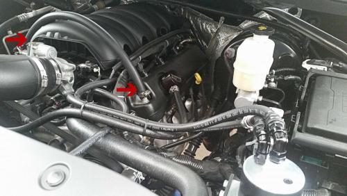

Do you have a picture of your install? I just installed the Air Raid Jr kit, and my Elite catch can and clean side separator just showed up. Would love to have a visual reference of the changes you made if possible :thumbs:
I'm sure it's just the angle but it looks like your brass plug on the clean side of the intake tube is cross threaded?
Agreed, looks cock eyed
The threads were tapped at a weird angle or the boss was not square with the tube. I had to check it twice when I did it. Every time I look at this picture it drives me nuts. It is air tight though!

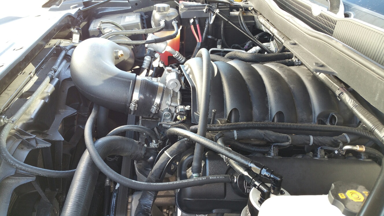

I dropped my truck off for some warranty work (shocks, loose driver's seat, etc) and the sales manager said my clean side separator was a "bad idea" and "could cause problems down the road" when referring to the bank-to-bank connection (see photo).
He mentioned that that type of system is only recommend for "long term/ high RPM type applications... such as towing". He also mentioned "by bypassing the PCV system, I no longer have any positive crankcase ventilation pressure".
I politely thanked him for his advice and input on the situation and went my way.
What all say the hive?
Guys, there are several threads on this subject on this site along with you tube videos. The service manger is mistaken. The 1/2" hose that goes side to side just seals the system back up so you do not have a vacuum leak. I guess he doesn't see the replacement for the breather with the hose going to the exact same place the previous ones do! Maybe he would be happier if there were two of them, one from each valve cover. When it's time to drain your catch can, go to that service manger and ask him how the oil and other crap got into the can if there is no PCV (positive crankcase ventilation) system in tact.
The oil catch can (any brand or model) does nothing more than run in-line to the existing PCV system. All you are doing is capturing some of the oil mist that is a natural by product (blow by) of the motor and converting it back to oil along with the other nasties. The water is from condensation on the outside because you are cooling off the mixture. Think of it like an in-line fuel filter. The clean air system is an add on that takes GM's dual side system that is routed to the air box chamber and redirects it to one valve cover with a cross over hose going from one side to the side that evacuates thru the replacement for the oil cap.
The only pitfall to this whole system, no matter how efficient, is that you have to empty the catch can occasionally. The colder the weather the more often you need to check it.
