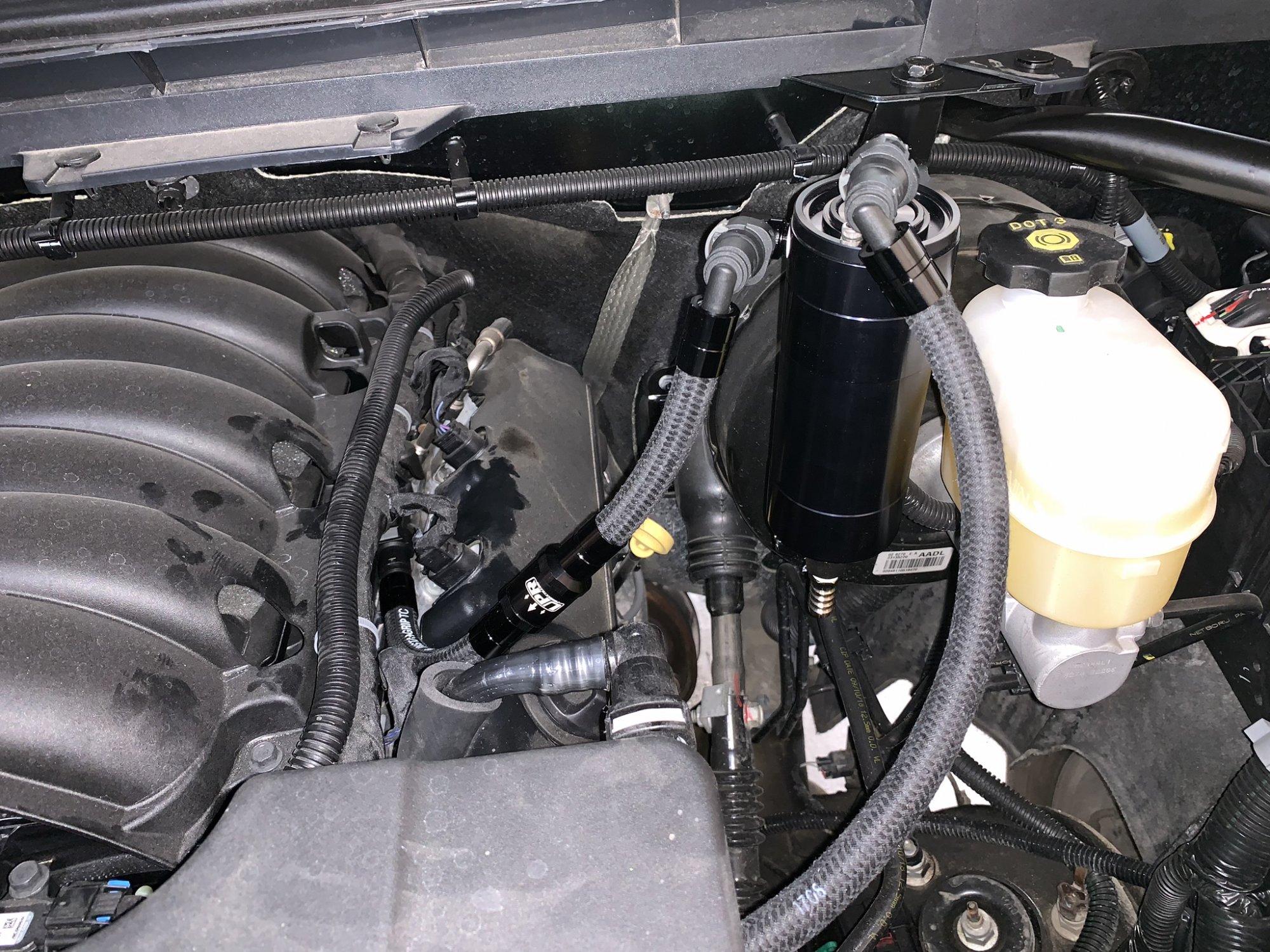

I'm just going to piggy back on this thread as I too utilized the deal Joe put out to the Forum. Spoke with "Steve" several times prior to Joe's offer as I tried to decide which route to take. He spent a good deal of time answering my many questions and in the end, they got my business. As has been stated, a very simple install, well made and shipping was very fast but I live Fla. so it didn't have to travel very far.
Here's a finished install pic.
