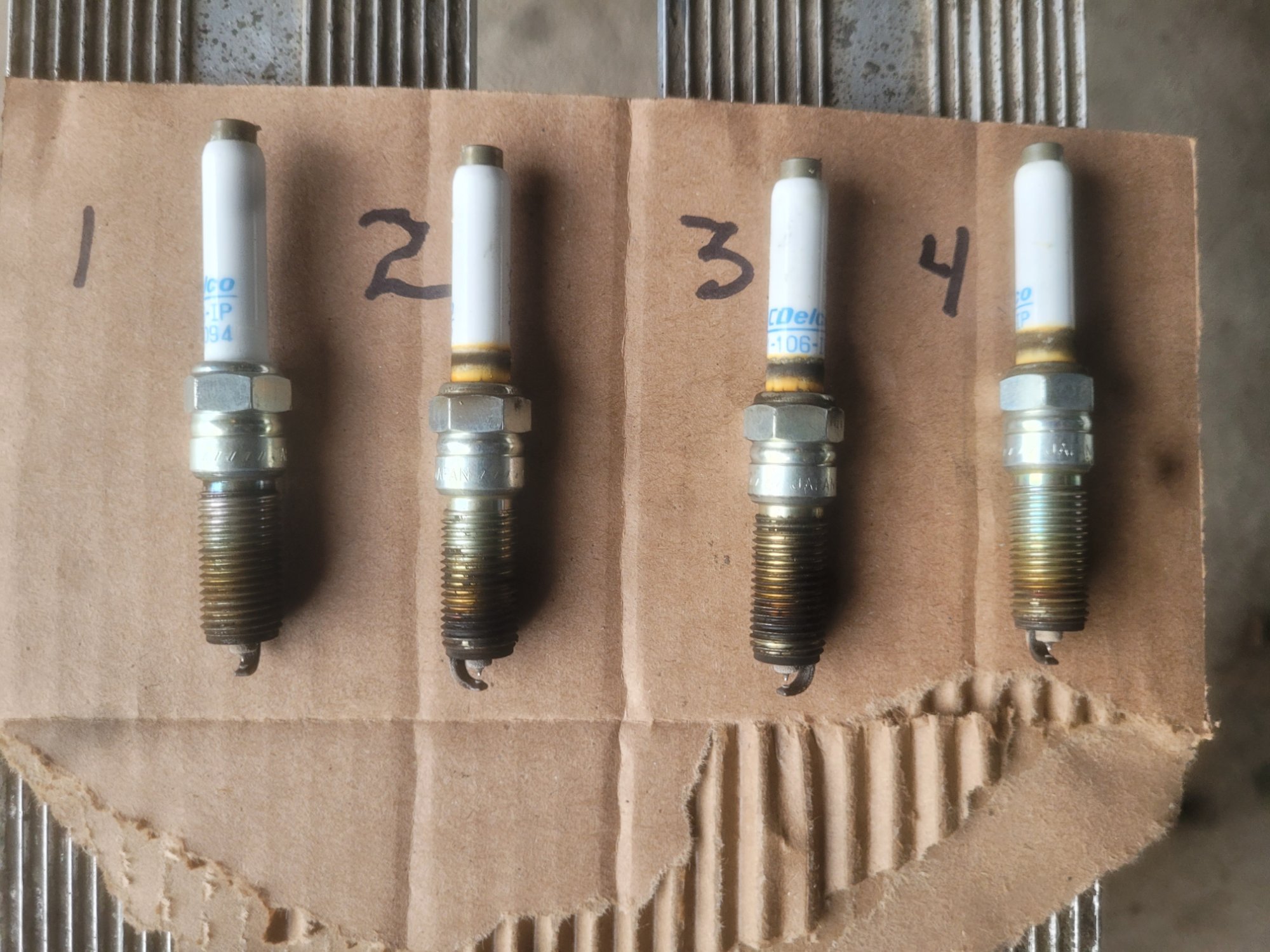

thanks fondupot for video on the spark plug. i am at 75k miles and decided to do mine today. did you have black rings around the porcelain , see pics only on 2,3,4. pic of 3 shows black streaks coming up from the base of the plug
