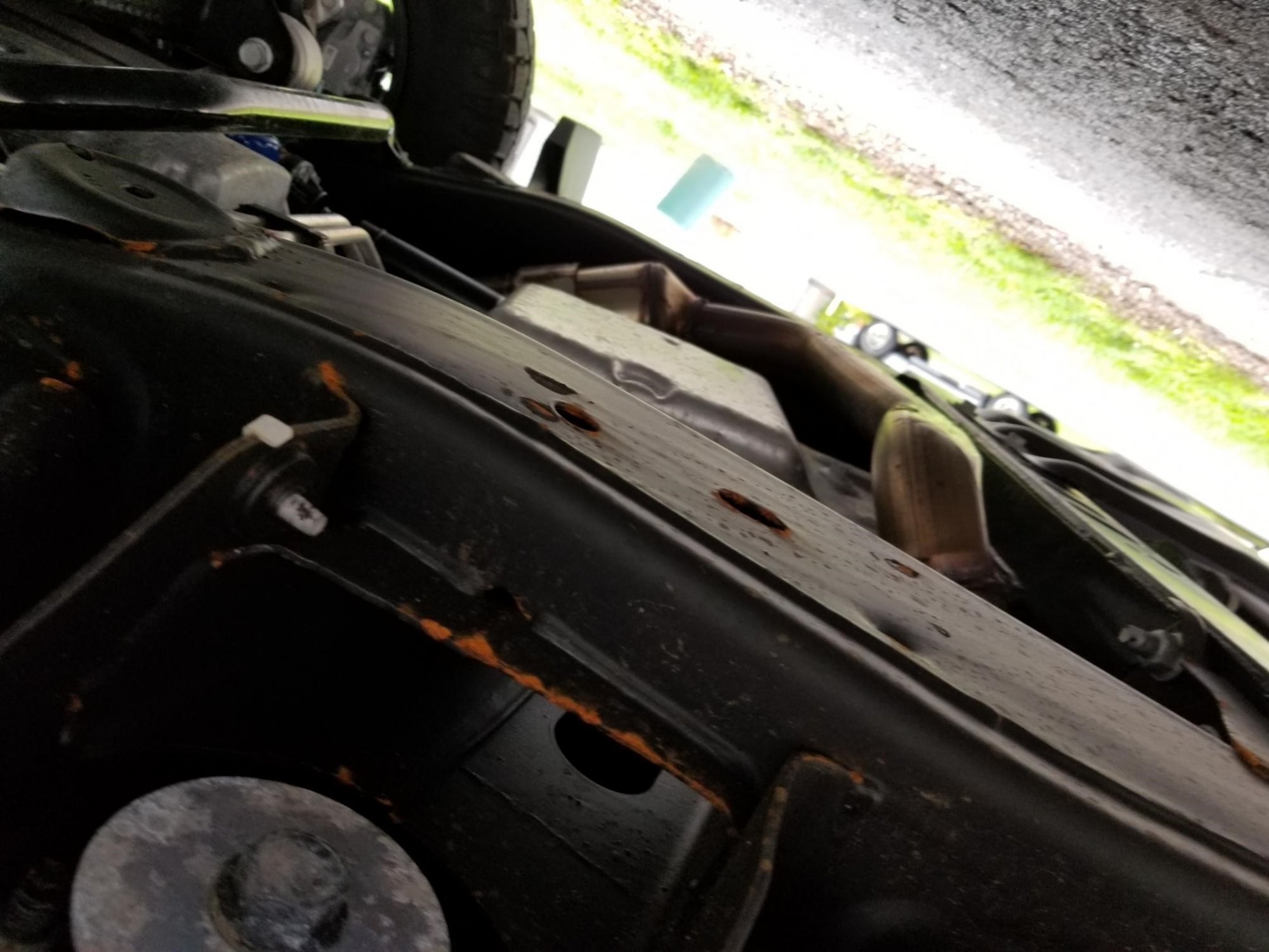

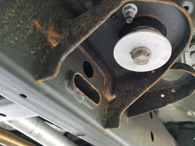

Anyone have frame rust yet? I do!
Just bought the truck a few weeks ago. I went to install side steps and I found some rust issues. Truck has a production date of 1/19 so its literally only a few months old and had only been on the lot for a month. Dealer says they are going to submit the pictures and see if GM will do anything. Truck is a custom trail boss.  There are plenty of spots doing this on the truck but these were the easiest ones to take pictures of.
4.thumb.jpg.0f4e8d9959ba8da6b572864e6a87f203.jpg3.thumb.jpg.10af58585ea718fb685430d20f682537.jpg5.thumb.jpg.db6e75112a3c6ef07d32f69c7f3edc93.jpg2.thumb.jpg.f617e6937d15ca1fc822960d44d84a34.jpg

I know you hate to see any rust on a brand-new truck, but those little spots aren't really any concern.  20 years ago, GM used to ship new vehicles with everything underneath already rusty.  And my 10 year old Silverado wasn't as good as yours underneath when new, but it sure is orange everywhere underneath now.  Still solid metal, no structural damage, mind you, just surface rust everywhere.  Looks bad.  End result of poor or nonexistent factory coatings combined with salt brine sprayed everywhere on the roads here in the winter.

It's caused by the wax coating drying out and turning hard or brittle. My 2014 doesn't look that bad but I went a different route on protecting the frame.

I saw several tucks new on the lot that had little spots of rust like the OP. Most of them were 3 Vin Mexico trucks. Mine was a 1 Vin and didn't have a spot anywhere.
I had the dealer undercoat the frame and will probably take it to Krown for a spray before they start salting the roads this fall.

The dealer said they should hear an answer this week. Worse case is maybe have it stripped and coated elsewhere? Not looking into sinking a ton of money into this issue.
Touch it up and move on. Not really worth involving a dealer unless the coating is sheeting off.
https://www.daubertchemical.com/store/product-list/corrosion-prevention/nox-rust-x-121b
Not unheard of to have superficial rust like that where the coating is thin around the holes and edges. I had to recoat my 19 and my 16 in those same spots. The nice thing is you’re seeing it early, so it’ll end there. Just go down occasionally and touch it up.
I mentioned my rusty frame to the dealer when I took it in before my 3 year warranty ran out. They offered to re-coat it for me. It was a vast improvement and still looks better than before, though I have already acquired new rust in the past 10 months. Its just what happens. Surface rust won't kill you, these frame will last as long as the truck's electrical components at least. GM doesn't want to make a vehicle that lasts 50 years, they want you back in the showroom in under 5 years.
