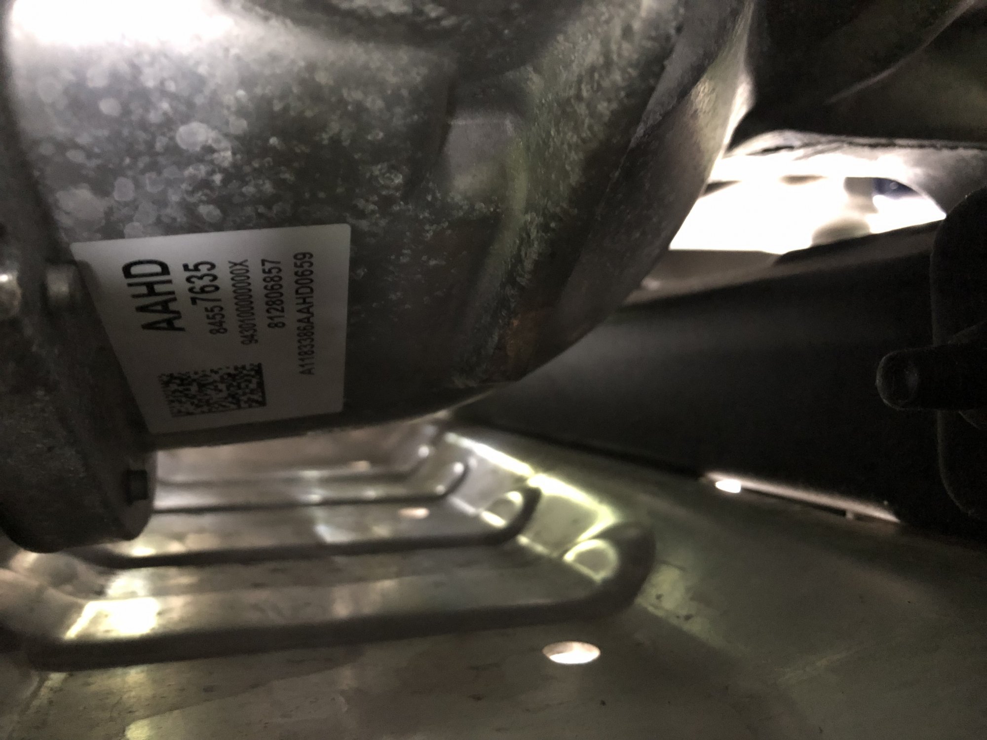

Yup. Also, if they have changed the design or modified the production of the AAM axle, there should be a new part number.
Here is the picture of the tag on my AAM axle. Could not decipher any date code but maybe one is a serial number. Either way, if you are having a new AAM axle installed, check the part number, it could be an indicator that you are not getting a new unit.

Here is the picture of the tag on my AAM axle. Could decipher any date code but maybe one is a serial number. Either way, if you are having a new AAM axle installed, check the part number, it could be an indicator that you are not getting a new unit.

Drivers side between the skid plate and the axle. Not that easy to see. Had to wedge the camera in there. You can just peek your eye up there though.
Yes its located under the Truck. From the drivers side crawl under your truck and look for the drivers side tire (D.S.T. / Red Arrow in picture) half shaft going into the front differential. The sticker is between the skid plate and bottom of the front differential (Red circle in picture)
Z06JPB posted a picture of the AAHD one. GM Part# 84557635
This is a picture of the AAJF one. GM Part# 84605752
The web site for the AAJF one GM Part# 84605752

the website list this at the bottom and states that the AAJF one
"Fits 2019-2020 new body Sierra pick up and Sierra Denali pickup with electric shift, #84605752 only!!"
It goes on to state that they (GM) make 4 different axles... So maybe 2 of them are the American axle ones and the other 2 GM axles???
I'm assuming that the AAHD and AAJF ones are American Axles???
Anyone have a part # for the "GM" stamped axles?
Hopefully this helps.
They make 4 different axles so you MUST verify this info or it will not work!
On the white sticker, the GM Part # is right there - if this matches, you got the right one: 84605752 - only! DO NOT GO BY VIN# ONLY - dealer did and got this wrong one!

I did not know there was another AAM produced one. My AAHD is from my Z71 LT  5.3L, 8-speed, Crew Cab.
It is possible the AAJF is for a 4cyl, or maybe it’s for the 6.2L, or maybe it’s for a 6-speed or 10-speed trans.
If there are two AAM axles it is very likely there are two GM axles. As far as we know, there are only two RPO codes; SU4 for an AAM axle and SU5 for a GM axle. The RPO doesn’t distinguish any other differences.
Will be interesting to see what others have and what engine/trans combo they have.
edited: just noticed the description said for a Sierra or Denali. Maybe the AAJF is just for the GMC side.
Edited by Z06JPB
