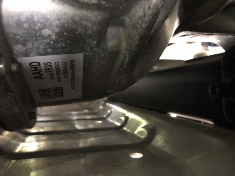

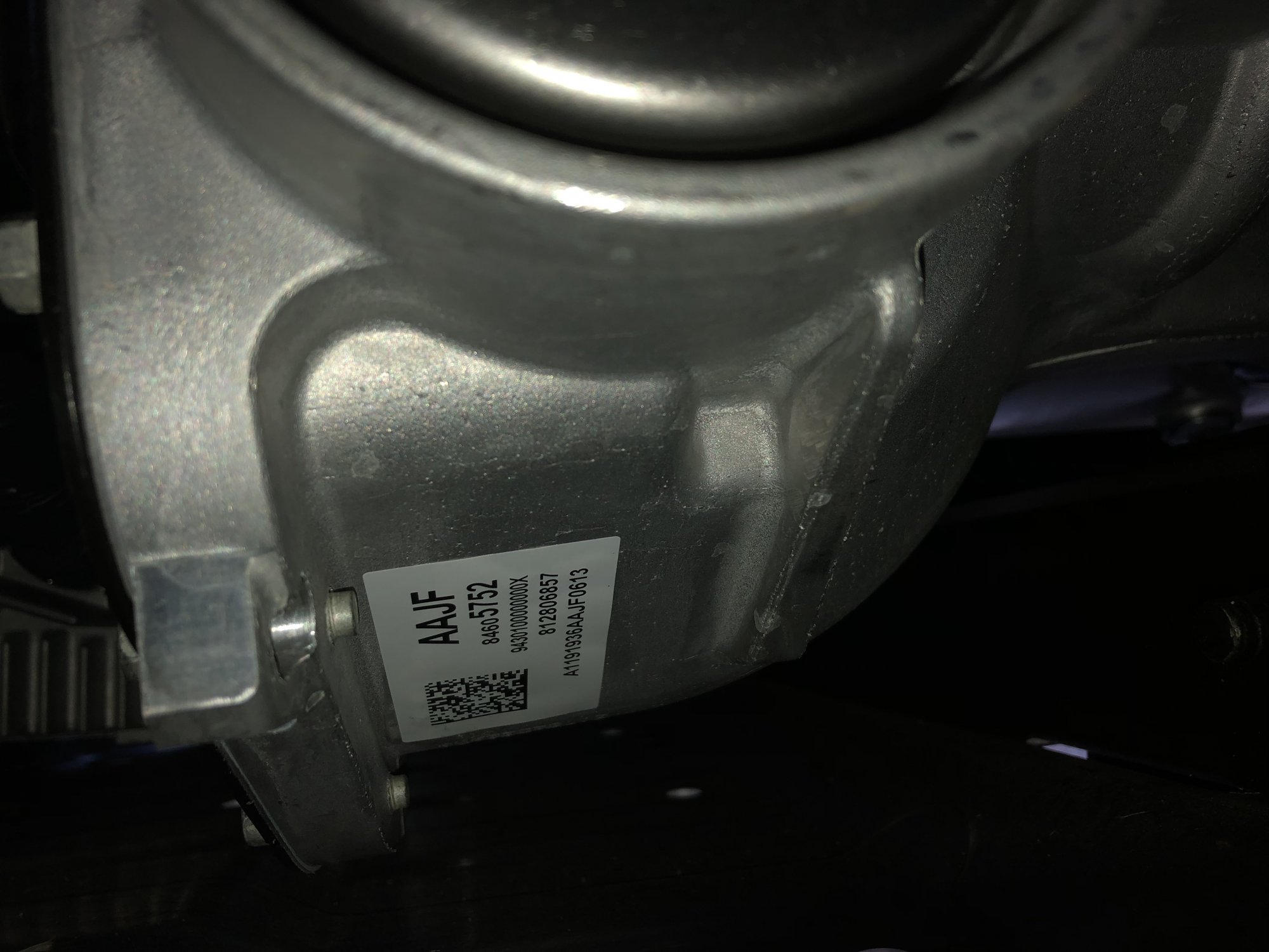

On 9/4/2019 at 6:25 PM, Z06JPB said:
Okay. Everyone get ready to have your mind blown...Did a little dealer checking this evening and discovered some interesting things about the GM and AAM front axles.
On the dealer lot I checked a LT Z71 Trail boss which had a an AAM front axle (SU4) with the AAJF tag and part number 84605752. This axle displayed the same movement and play as the video by Limelight on page 1. Mind you, I did not drive the truck so no way to say if it makes noise while driving.
I MESSED UP! I did not find a GM axle on that Custom Trail boss. What I found was an AAM, AAL8 marked axle.
The AAL8 axle IS a GM axle! I found this axle on a Custom Z71 Trail boss 5.3L 6-speed.
The tag for the AAL8 axle is not in the same place as the AAJF and AAHD. It is on top of the axle. The "GM" symbol is cast on the driver's side just ahead of the drive shaft. The AAL8 is shaped very different from the AAM AAHD and AAJF axles. The passenger side axle extension is round shaped where as with the AAM it is square shaped.
https://www.bonanza.com/listings/New-Gm-Oem-Gmc-Sierra-1500-Denali-19-20-Silverado-Front-Axle-Differential-Locker/755810401
Also note, the part number for the AAL8 axle is 84659680. This part number is too new to come up in a search. The AAL8 axle still had the same play and movement as all the AAM axles I have tested including my own like Limelight's video shows on page 1. Seems like maybe that movement is unrelated to the noisy jingle or clicking that some are experiencing as the SU5 GM axle is unaffected.
In my truck, I have the AAM axle that is denoted as AAHD on the tag and my axle is super-quiet. Of the forum members having problems with the noise in their AAM axles, how many are AAHD and how many are AAJF?
Pictures are attached. First pic is the tag from my LT Z71 5.3L 8-speed with the AAM AAHD axle. Second picture is from the LT Z71 Trail Boss 5.3L 8-speed with the AAM AAJF axle. Third picture is axle tag from the Custom Z71 Trail boss 5.3L 6-speed with the GM AAL8 axle. The fourth picture shows the underbody of the AAL8 axle and how it is different from the AAM axles.
