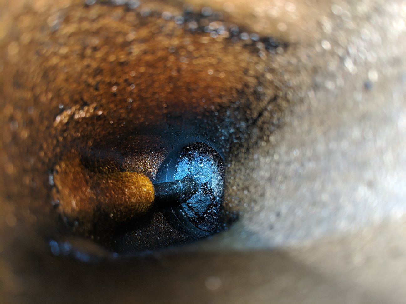

Centex14 Posted May 23, 2019 Posted May 23, 2019 Here are some of my intake valves at a 130k miles with no catch can. After seeing these I'm even less concerned about running a catch can.
Jacoby Posted May 23, 2019 Posted May 23, 2019 2 hours ago, Centex14 said: After seeing these I'm even less concerned about running a catch can. Those look like shit. 4
Centex14 Posted May 24, 2019 Posted May 24, 2019 Looks aren't everything. Truck still gets great mileage, doesn't burn oil, doesn't knock, tuner didn't see any issues in the logs, plugs look good. I see no reason to put a can on. I can spend that money elsewhere. 1
UnlimitedMatt Posted May 24, 2019 Posted May 24, 2019 2 hours ago, Centex14 said: Looks aren't everything. Truck still gets great mileage, doesn't burn oil, doesn't knock, tuner didn't see any issues in the logs, plugs look good. I see no reason to put a can on. I can spend that money elsewhere. Fair enough. But think about how much better it *could* be if your values were clean... 2
3tspapat Posted May 24, 2019 Posted May 24, 2019 Looks aren't everything. That is why the world is full of ugly people still. 3
Jacoby Posted May 24, 2019 Posted May 24, 2019 3 hours ago, Centex14 said: Looks aren't everything. Truck still gets great mileage, doesn't burn oil, doesn't knock, tuner didn't see any issues in the logs, plugs look good. I see no reason to put a can on. I can spend that money elsewhere. Putting a can on at 130k miles is about as pointless as those pictures u posted. A catch can is a preventative measure not a cure
JONBLARC7 Posted May 24, 2019 Posted May 24, 2019 Show me a picture of a valve with 130k miles with a catch can the whole life of the motor. I bet it looks just as bad. 2
Mike GMC Posted May 24, 2019 Posted May 24, 2019 While I agree those pics don't look good, I would have imagined much worse at that mileage with no can. The valves on my 08 CTS looked much worse at less than half that mileage. I did a mechanical cleaning and added a can. At 110k miles the valves looked slightly better than those pictured, but MUCH better than they did at 60k when I cleaned them and added the can. At 60k, mine looked like the horror story picture you see posted as an add for cans.
Centex14 Posted May 24, 2019 Posted May 24, 2019 Forced induction is a different story and I'll agree those need a can. Naturally aspirated it's no where near as important as the internet makes it out to be. But you do you. I wasn't worried about it before and I'm most certainly not worried about it now.
Centex14 Posted May 24, 2019 Posted May 24, 2019 (edited) 3 hours ago, Jacoby said: Putting a can on at 130k miles is about as pointless as those pictures u posted. A catch can is a preventative measure not a cure OP asked about long term carbon deposits. I have pictures of my valves at a 130k miles which is long term. Pretty certain that's the point of this thread. Edited May 24, 2019 by Centex14 2 1

Jacoby Posted May 24, 2019 Posted May 24, 2019 1 hour ago, Centex14 said: OP asked about long term carbon deposits. I have pictures of my valves at a 130k miles which is long term. Pretty certain that's the point of this thread. Yes he did and your pics provided more than enough proof that a catch can is needed. So I say thank you
Doublebase Posted May 24, 2019 Posted May 24, 2019 Those valves don't look reassuring to me. And 130,000 miles? I mean, I thought 130,000 miles wasn't supposed to be high mileage anymore? Those valves look like something I'd expect to see from a carbureted motor at 130,000 miles, from someone who never changed the oil and beat the tar out of it.
