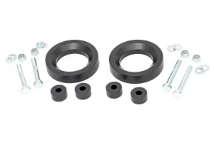

As for the comment hoping I find it's installed improperly that's not going to happen.  It's a simple straight forward installation of a simplistic spacer. Pull the wheels, loosen top strut tower bolts, pop UCA ball joint, disconnect the steering arm and sway bar and then slide the spacer in below the lower shock mount securing with provided hardware.  Do the exact same on the other side and then reverse your steps and you're done.  It's that simple....

It just sounds like the 2 inch level was too much. Back it down to 1.5 or 1 and the problems most likely will go away. Good luck.
Thanks.  I'm going to take your advice and try a 1.5" piece and see if that resolves the issue.

What is your engineering degree in and how does it apply to knowledge and abilities with automotive suspension systems? I have family that are engineers but their Electrical and Nuclear degrees mean squat in the automotive suspension world. What dictates you are an automotive professional? Do you take car pictures? Sell them?
If you are as intelligent and you make your self out to be, take a look at the differences between a standard 4wd truck suspension and what is added to create the AT4/Trailboss lift (yes lift, that is what they specifically call it in the press release and on their website and can easily be identified by what they use to achieve it). So think about the lift type they use (hint, it is a shock type lift), what is not changed as the engineers who designed the truck and obviously know more than you deemed a safe level to operate in (that is 2 inches), and finally what you are doing which is effectively stacking two lifts together to get 4 inches (the 2 inch shock lift and 2 inch spacer lift). That 4 inches I promise is well out of what the engineers acceptable range for their regular unchanged components. They don't use different springs (the correct way to lift a vehicle), they don't change the control arms, tie rods, etc. This is what they change: "different CV shafts, new front impact horn lowering adapter, taller front struts, longer rear shocks, rear spring spacers, taller jounce bumper mount, u-bolts/nuts". So put your engineering mind to work and let us know what you did wrong to create this issue...
As others have noted and you sound like you agree with, going with a lower spacer would help get the vehicle closer to the acceptable parameters set by your brothers the automotive engineers. They don't have to plan for their stuff to work outside of how it leaves the factory weather it be stacking lifts or adding a blower.  My suggestion, go with 1" as that is close enough, the further you get away from stock the better chance you have at messing something up or having it wear out sooner. That is why I went with 1.5" originally on my K2 and recently needed a shock shock change so went with the 1.25 setting from Bilstein (which is effectively the same way the AT4 and Trailboss get their lift), I didn't want to put the most stress on my stock set up as I wanted a happy medium. I know there is only so much range of motion and the further I deviate away from that the closer I am to expired time on those components. Good luck, I have a feeling that will alleviate the binding...
