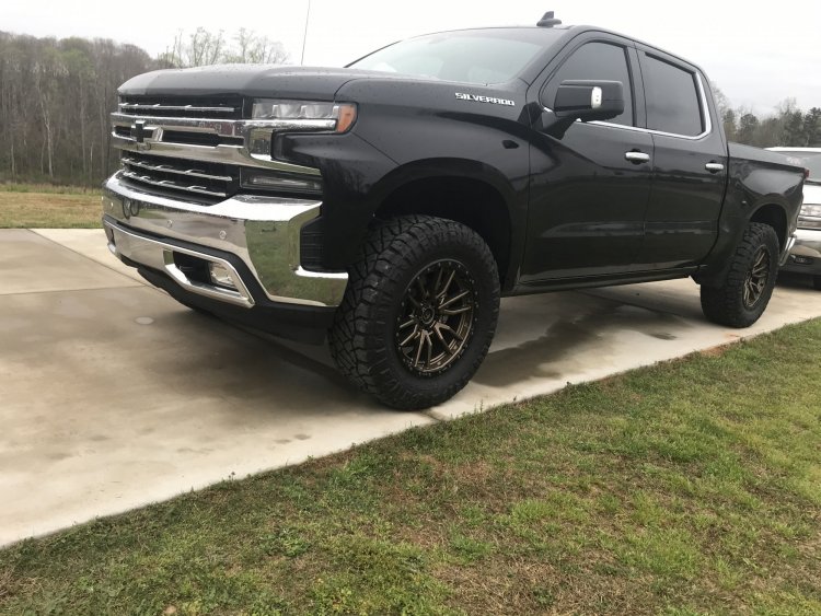

On 7/30/2019 at 9:38 AM, Bluerado23 said:
299a0fecb0149ef80c57a066d1657cc6.jpgad3247efeec5ef396c7e8bca57396d7f.jpge34a6977b7cd2ef77a76dba3e56f32a2.jpg
315/70/17 KO2
17x9.5 Black Rhino Roku +12
2 inch ready lift level
Slight rubbing on inner part of mud flap.

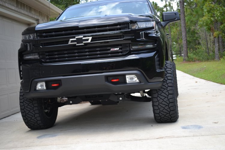

On 7/15/2019 at 6:42 PM, BlackLS said:
20x10 -18 Fuel Mavericks
6mm Bora hub and wheel centric spacers
Nitto Ridge Grapplers 35x12.5
2" Trail Boss Lift + 4" BDS Lift = 6" Total
Mud Flap bracket delete
Tied back the front of fender liner

On 7/15/2019 at 2:09 AM, GJM32387 said:
Fuel Rebel 20x10 -18 Offset
No spacers
Nitto Ridge Grappler 295/55/20
Factory Trailboss Suspension
Slight Rub on mudflap on full lock.
