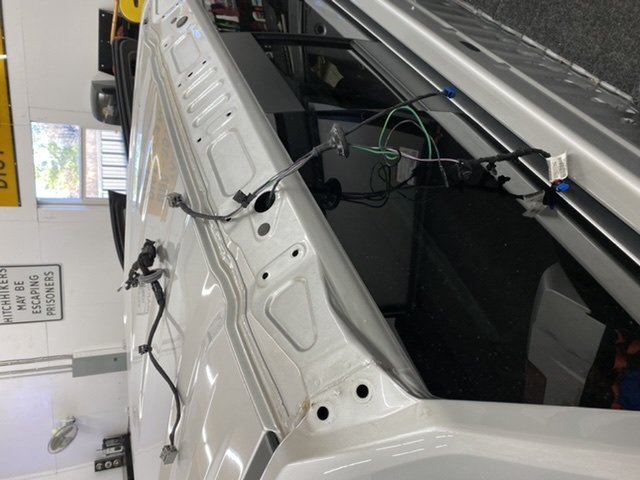

Finished it up today, I was able to remove two rear and side plastics and 2 hooks above rear doors, then carefully pulled down headliner to free it from rear window trim. After that things went pretty smooth.

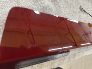

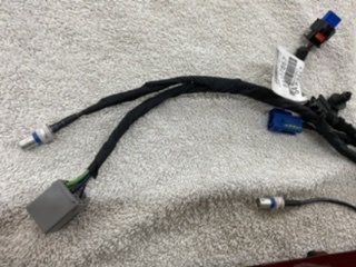

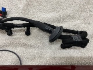

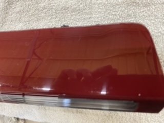

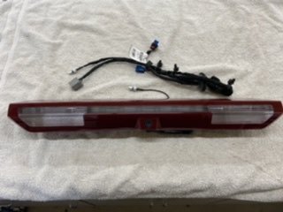

If anyone is interested. I have an extra setup, I ordered lamp from two different places, got second lamp in today,  lamp with camera and used wiring harness, I got harness from a wrecked 19 with under 100 miles. I watched guy pull harness from truck, he didn’t damage it.

Yes with lamp and this harness you will not need spoiler. If you order only lamp from GM you would not get This wiring harness.  I just listed it on for sale thread.
