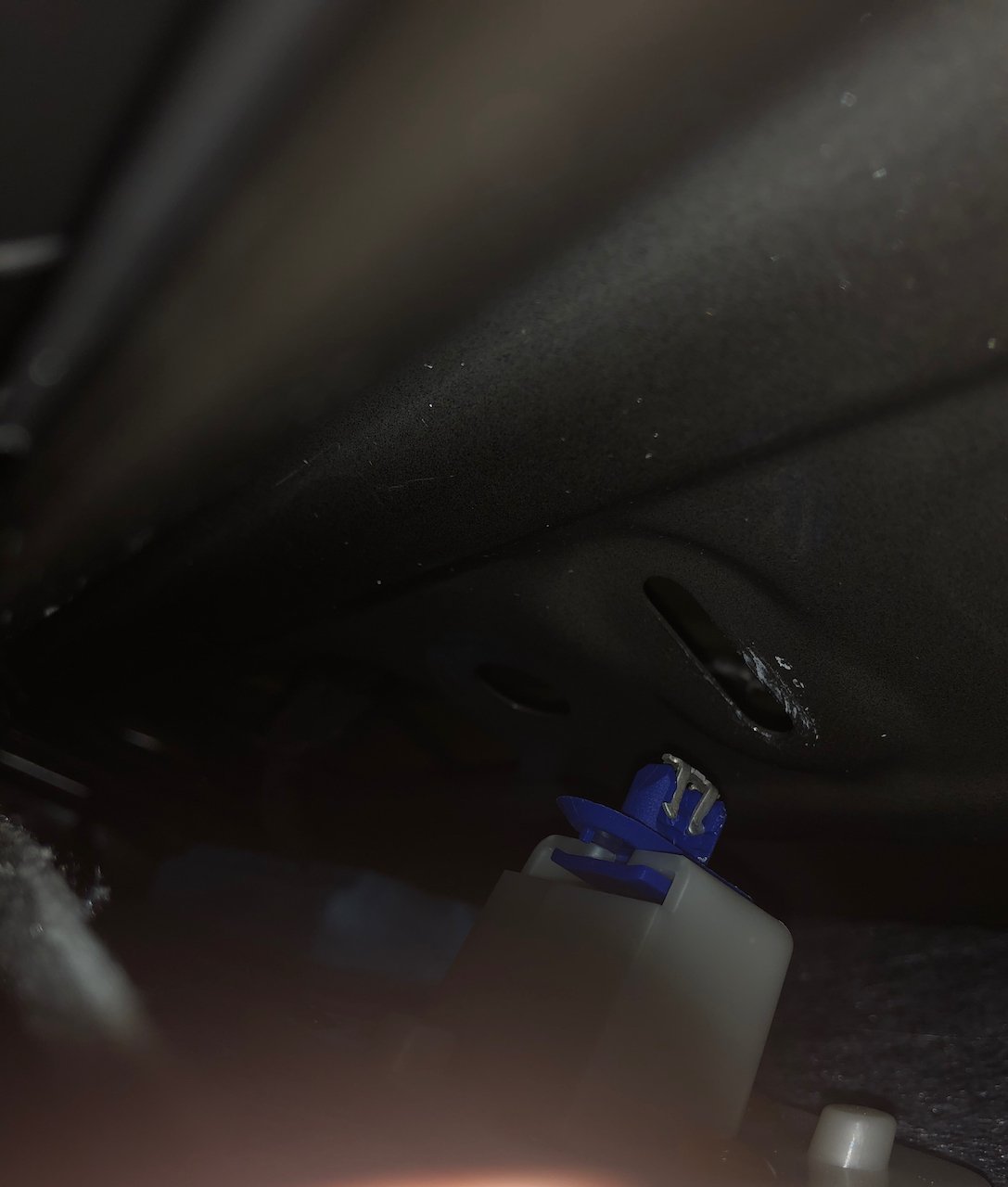

The hardest part in our case was popping the two clips that hold the headliner up by the rear window. I think they broke when we pulled it down, so I think I'm going to be ordering some new ones.  I think the metal component of the clip is busted (see pic). Not sure how I could have pulled it down any different.
In any case, everything else was super simple, I'm pleased. So grateful for everyone who posted info and pics.
Great job man, those two clips separated from headliner when I pulled, I just applied a light coat of gorilla glue on reinstall.

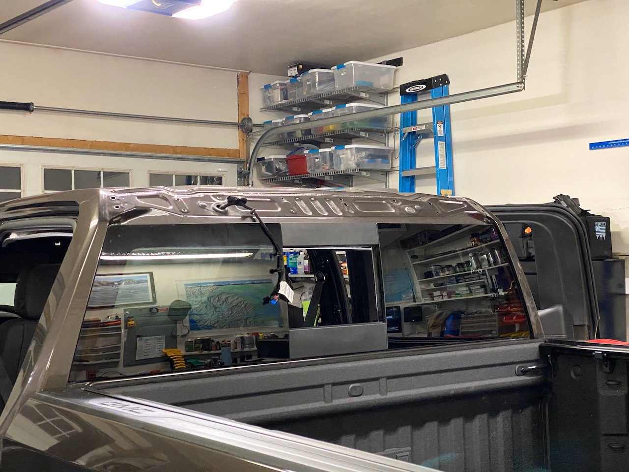

I am looking at doing something slightly different with this setup, and I have a few questions. Does anyone have an idea of how long the coax cable is ( 84335461) ? And also, from what I can tell the camera looks like it can be removed from the brake light housing. Can anyone confirm? I am looking to move the factory camera and install it on the back of a cap. I purchased the short harness that goes through the spoiler last week from the dealer, as that is the only one we could find on their system. I think with the coax cable, I could just plug it into the existing one which I think would make it long enough to run to the back of the cap and just plug the camera into that.
There are two screws to pull the camera out of the brake light housing, though I admit I didn't try it.  The cable is about 7' in length (at least mine was).
Great! Thanks! I am going to give that a try. The box is 6’9”, and the cable between that one and the camera is about 2’, so hopefully about 9’ of cable total. I will just have to try to figure out a way to mount the camera on the cap.

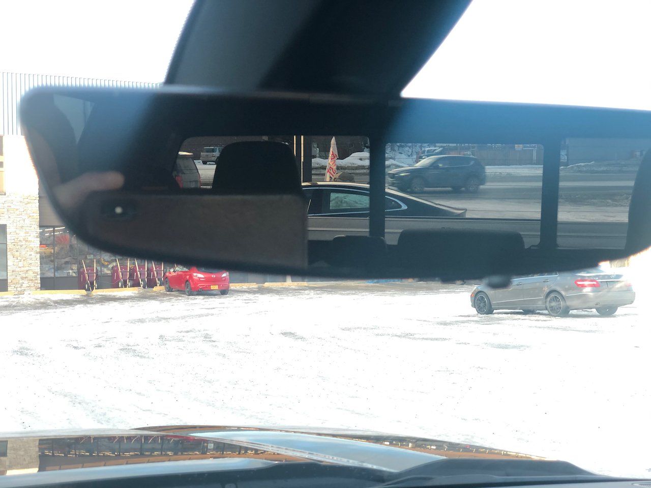

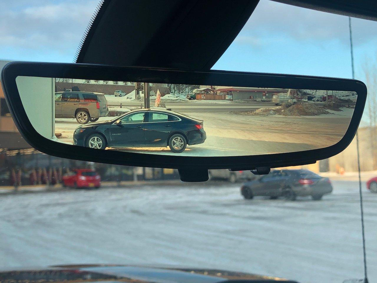

So in my opinion, I find it much more useful at night than the mirror.  I am able to makeup a lot more of what's behind me other than just headlights.  However, it is winter here, so 70% of what I see is white :)  However, day or night, I rarely use the mirror anymore.  Here are some more thoughts:
Colors are more washed out than the mirror.  It's a high res screen, but clarity and color can't compare with the mirror. I was also tempted to zoom in all the way in order for objects to appear the same distance in either mode. This probably makes things even less clear because I suspect it's a software zoom, not optical.
Took my brain a while to context switch between the road (glass) and the screen. I didn't expect this, but I'm finding it's going away over time.  It's odd because I don't have that issue with the infotainment screen, but for some reason, the first time I used it, it took a couple seconds each time i'd look at it, for my brain to focus on it.
Perspective. Much improved. I can watch a car in the rear mirror and as soon as it leaves the focus of the mirror, it's starting to show up in my side mirrors, or at least my mirror light shows something is there for the brief moment.  There was a much bigger gap before.
Headlights at night, even though it was auto-dim, don't have nearly the washout effect when using the screen.
The obvious, way more usable data because you aren't blocked by seats, window, etc. Overall, the good far outweighs the bad for me. I love it. i hope this helps.
