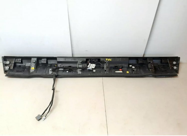

Does this spoiler look complete with required wiring?
Did you get it painted the right color or you ordered it already painted?

The lamp bolts to the spoiler with 4 torx. Piece of cake to swap out

I removed to two rear plastic panels that are at the upper rear corners of back seat. (Rear seat belt slide through them)  I can see the two bolts on each corner. Are these the only bolts that hold spoiler to truck? Are the middle ones “panels pops”? Just want to make sure only those 4 bolts to remove before I start prying this off tomorrow. Thanks again for all the help!
