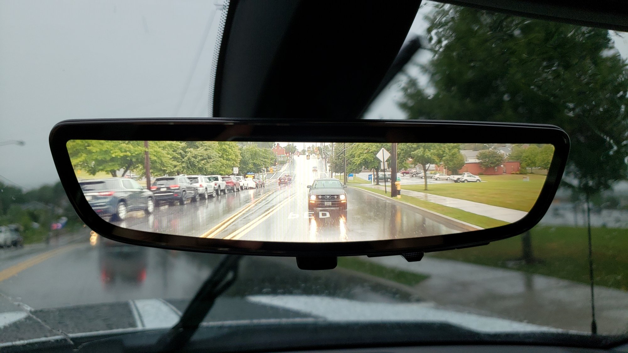

On 7/11/2020 at 6:33 AM, Kyle's AT4 said:
Here you go. I found some camaro ones for 200 ish I just need to verify they fit2ab98192beb6a759034c55d588692fa0.jpg

So has anyone confirmed that the Gen 1 mirrors don't work with our truck's?
Edited by Robert G
spelling
i used a blazer mirror for mine. it hooked right up.  pictures great.
Can you post a pic of it?
