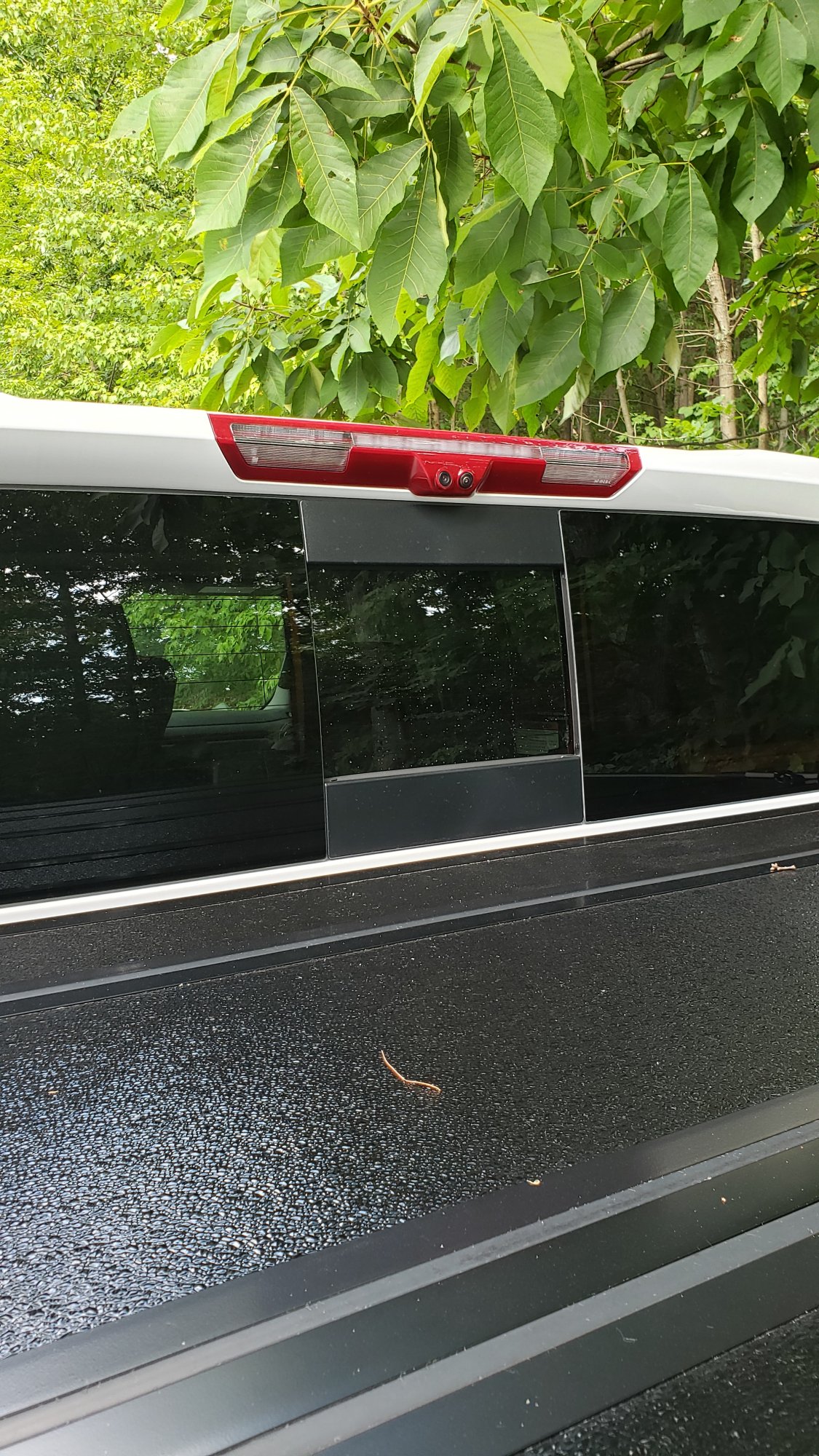

does any one know the part number for the actual camera inside the light? I did this install with a rear view mirror cam/bed view cam lense and did not look before i put it on. i have a high mount light but it is a bed view type cam and i want to put rear view mirror cam in it to sell.

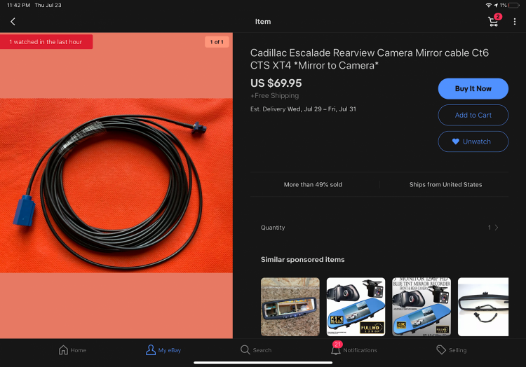

Can someone look up the coax cable for a escalade or tahoe, that one would be longer and eliminate the issue with having to order a new spoiler.
I’ve seen this one a few times. It says it fits model year 20’ Escalade and xt4. Fiat, do you think this would work ? Or is the housing with harness still the only way to go?

I think that is high mount light part number. heres a pic of mine. i want to verify what cam is in the light.  I had a bed view cam in my mine 84676845 also same type they use in 360 view cams in 2020 models.  i am trying to figure out if rear view mirror cam has a different part number.
