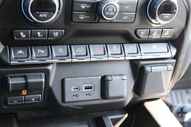

The one in the dash or whatever like in this example picture.   I tried a new cable and nothing.  It seems a little loose.  The USB port next to it works fine.  Any chance this is an easy fix?

I just got a 19 Sierra AT4 and was reading the manual (I know read the directions right hahaha) and it said to use the original usb-c cord the phone came with as aftermarket cords my not work. Just a thought that might be worth a try.
Something else on the USB C, I believe that is used for charging only. Make sure when you get the USB C cable that it is rated for charging or it won't work. There are a lot of cheapie USB C cables so get a good one. I use the port to charge my laptop and it woks quite well.

The USB-C port in my 2019 Silverado RST stopped working, I initially thought it was a bad cable, which it wasn't. I then pulled fuse F26 located on the passenger side of the dashboard, which reset power to the USB port assembly and it fixed the issue. I hope this helps.

Bought an original NEW OEM Samsung charging/data cord from Samsung, for the "Type C" USB Dash infotainment system and not working, a friend owns a Z71 and his works with Android Auto, but when he plugs into mine "nothing", they need an over-current protection fuse built into the modules with a 3.3V surge protection reset button recessed in a hole that can be reset with a paper clip.  Either the module is burning out or the fuse on the mainboard of the infotainment system is getting fried.  Either way, for as much as you pay for the damn trucks you would think an engineer at GM would realize this and call their "Electronics Supplier" to solve the issue, and maybe get an interpreter to speak the suppliers language!  This is Bull Crap!
