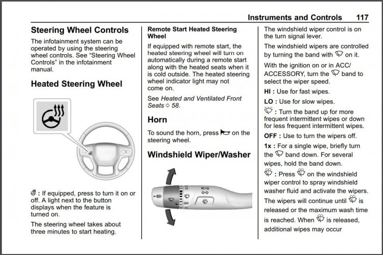

My Silverado LT 6.6 Gas turns on the heated steering wheel with the remote start and I can feel that much faster than the heated seats, even though I only let it run with the remote start for about a minute or less. My steering wheel heater does turn on with the button as well, which I've done several times after getting in the truck and "starting" it. I know there is a setting in the options menu to have the heated seats turn on with the remote, do you have the option turned on? Even though it should turn on and off with the button anytime.
https://my.chevrolet.com/content/dam/gmownercenter/gmna/dynamic/manuals/2020/chevrolet/silverado-2500-3500/2020-chevrolet-silverado-owners-manual.pdf
