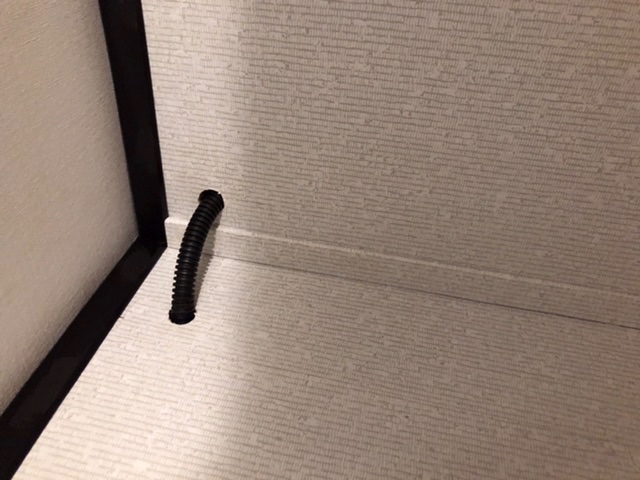

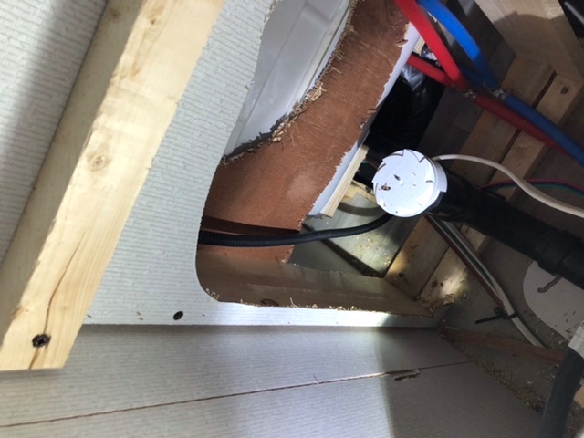

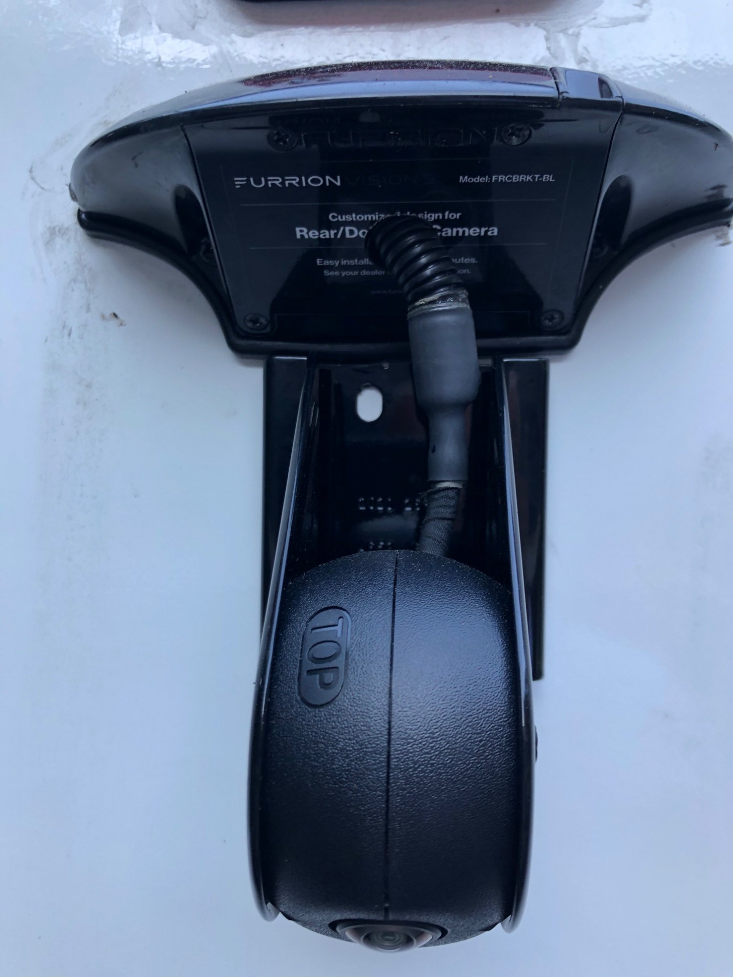

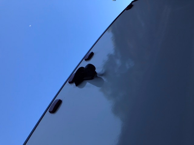

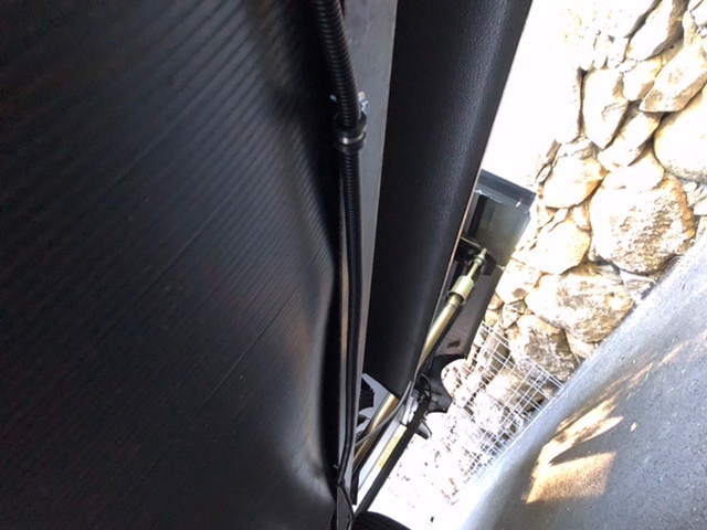

I bit the bullet and bought the factory GM camera. I did the install today using the factory furion mount. Popped the hole behind the mount into the rear top bunk, then into the shower wall and fished up the length of the trailer. I coiled the excess wire up and secured in the underbelly. I will say the camera is crystal clear and I can’t wait to use it on my trip. I opted for the plan model camera that doesn’t have the invisible view. I highly recommend it. 8A6B994A-DBFF-480F-B0A5-863011A54ABF.jpeg.2e3cd39436351d0f2f025885d9b5cf2f.jpeg
Great job, you’re going to love it. I agree that the image is crystal clear.
I like the idea of going through the hole already there from the Furrion camera.
They need a wireless version that connects to the infotainment system. I've tried a few times and my 5er is just too long and I keep snatching it out of the end. I went back to my Furrion wireless observation camera. On the plus side, I can put the monitor inside and watch what's going on. LOL!

The camera is marked "top" and the cord exits the camera body going up no matter how you position the bracket.  If you turn the camera over, the image would be reversed.  The loop isn't ideal, but it is necessary if you are going underneath.  I'm debating painting the cable the same color as the trailer just to make it stick out less.
