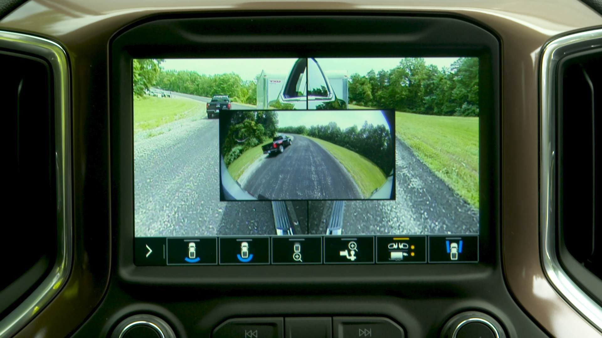

1 hour ago, sdelam said:
i have mine mounted above the rear door of my work and play. The invisable trailer does work well there, it will come up occasionally but looses its calibration more times than not. When it does not work and that view is selected, it reverts to the 3 way split screen that shows the left and right trailer sides and a box in the center of the screen shows the rear. Which is also a selcetable camera view btw.
I would love for somebody to show us a photo of these. There's a real lack of info on what options we have and what the infotainment screens look like in the various modes.
stole this off the internet
https://www.equipmentworld.com/chevy-wants-to-make-towing-easier-with-2019-silverado-1500s-new-tech-cameras-apps/
https://www.chevrolet.com/trucks/silverado/camera-technology
