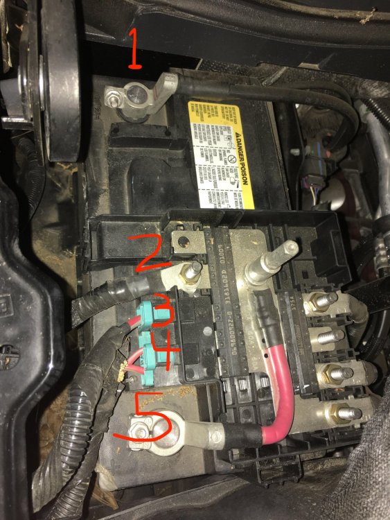

I've got a dead battery in my 2017 Sierra Denali 6.2L. Died out of nowhere, pretty sure this is the original battery (I just bought the truck last year). Started with a jump yesterday and drove fine, now it won't crank up today.
I went to start taking the battery out and all I have to say is WOW did they over-complicate this... Do I need to disconnect all numbers 1-5 in the photo attached, then push that little bus block or whatever over to the side in order to replace the battery?? Seems excessive. The YouTube video I watched has a 2015 5.3L silverado and they don't have 2, 3, or 4 on theirs... I guess that's a 6.2L thing??

Found this one, should answer your question, truck in video is a 17.

Wow of course I overlook the one video that shows a 2017... Thanks very much!
