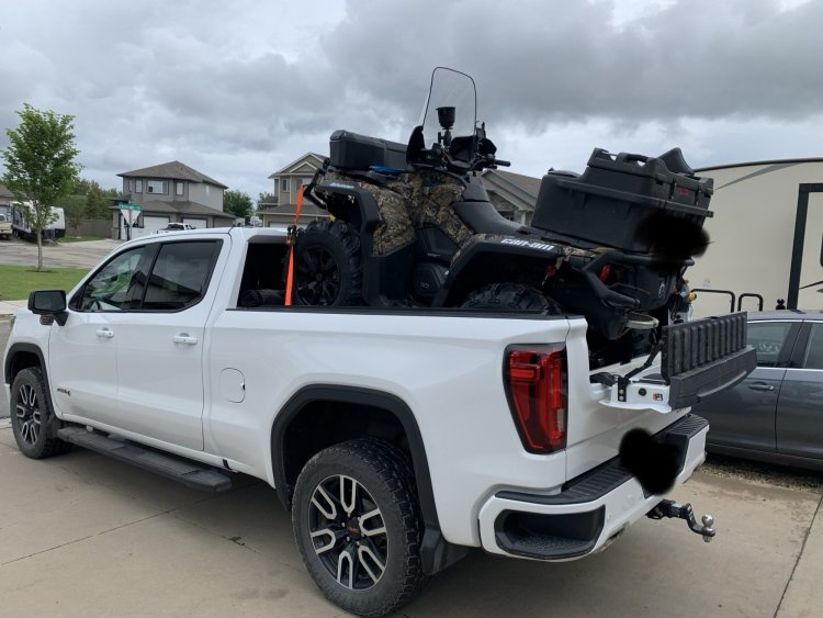

 I recently bought a 2020 Sierra AT4. Put an ATV in the box this afternoon. It’s on a riser in hopes that the tailgate would shut which didn’t quite work out.  I opened the step and closed the tailgate. Now I can’t get the tailgate to open to get the ATV out. Step will not close as the backend of the quad is in the way.
is there anyway to get the tailgate open now? Manual override? Something....
Is the ATV pushing against the tailgate?  If so you may have to get 2 persons and each person push in on the outside of the tailgate near the latches and then try pushing the button to see if it will release.

When pressing the tailgate release button on the key fob I can’t hear it even try to release.

Yea, my idea was going to be stand the ATV up a little bit more on it's back wheels to relieve the pressure that is causing on the gate.

Figured it out. The quad wasn’t actually touching the tailgate. Ended up having to manually flip the latches where the stair connects to the main part of the tailgate. Fooled it into thinking the step was up. Once I did this the tailgate opened. Now time to go for a ride!

It is designed to not open the main tailgate if the smaller portion is open.  It is a safety feature so that if you have a trailer hitch in and try opening the tailgate with the smaller tailgate already open, it won't let it.  Nothing wrong with it, it is designed that way to prevent possible damage.
Makes sense of course. Would be nice if they had some form of override for it though. I pull trailers around almost everyday so taking the hitch out is not an option!
