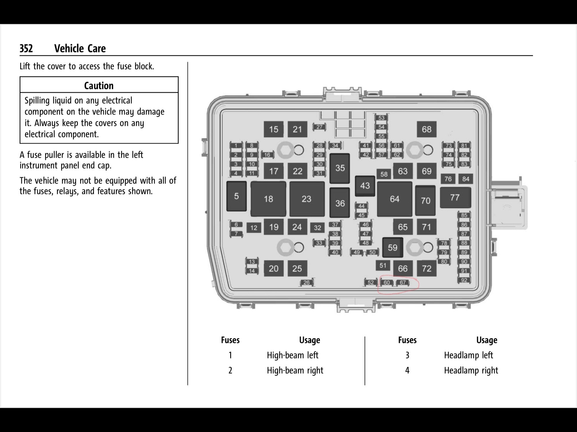

The images below are from pages 352-354 in my 2021 GMC Sierra owners manual. In the engine compartment fuse box, it shows #60 and #67 are the Active Fuel Management 1 and Active Fuel Management 2 fuses. Maybe there’s another system involved as well.
I hooked up to my Bluetooth scan tool yesterday and I cannot see anyway to monitor how many cylinders are active in real time. I do believe pulling the fuses works but I have no way of proving it.
