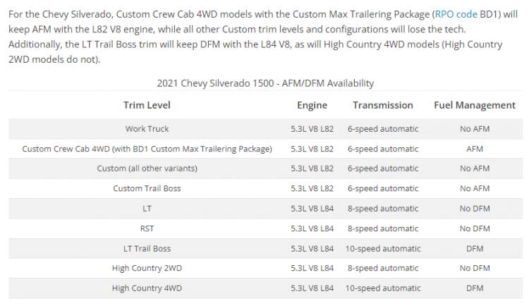

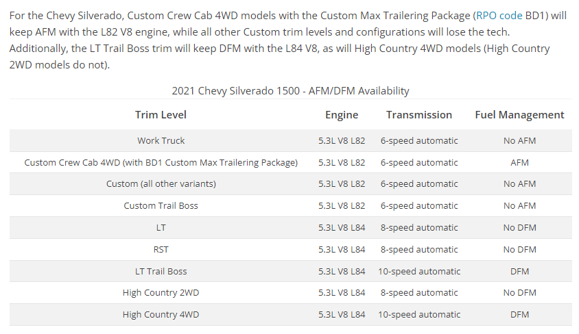

OK I will be the dummy... there are 21s with no DFM? or are you talking disabled with a tuner? How do you know if you have or dont have DFM?
You can check the RPO codes, I also read its on the window sticker as a $50 credit.  Check some of the older posts about it they list what to look for.
Try this for starters.

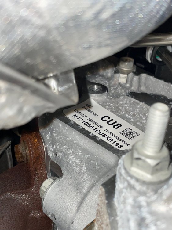

    • Ok, I got the all the codes. What do you all think would be a place to start?
