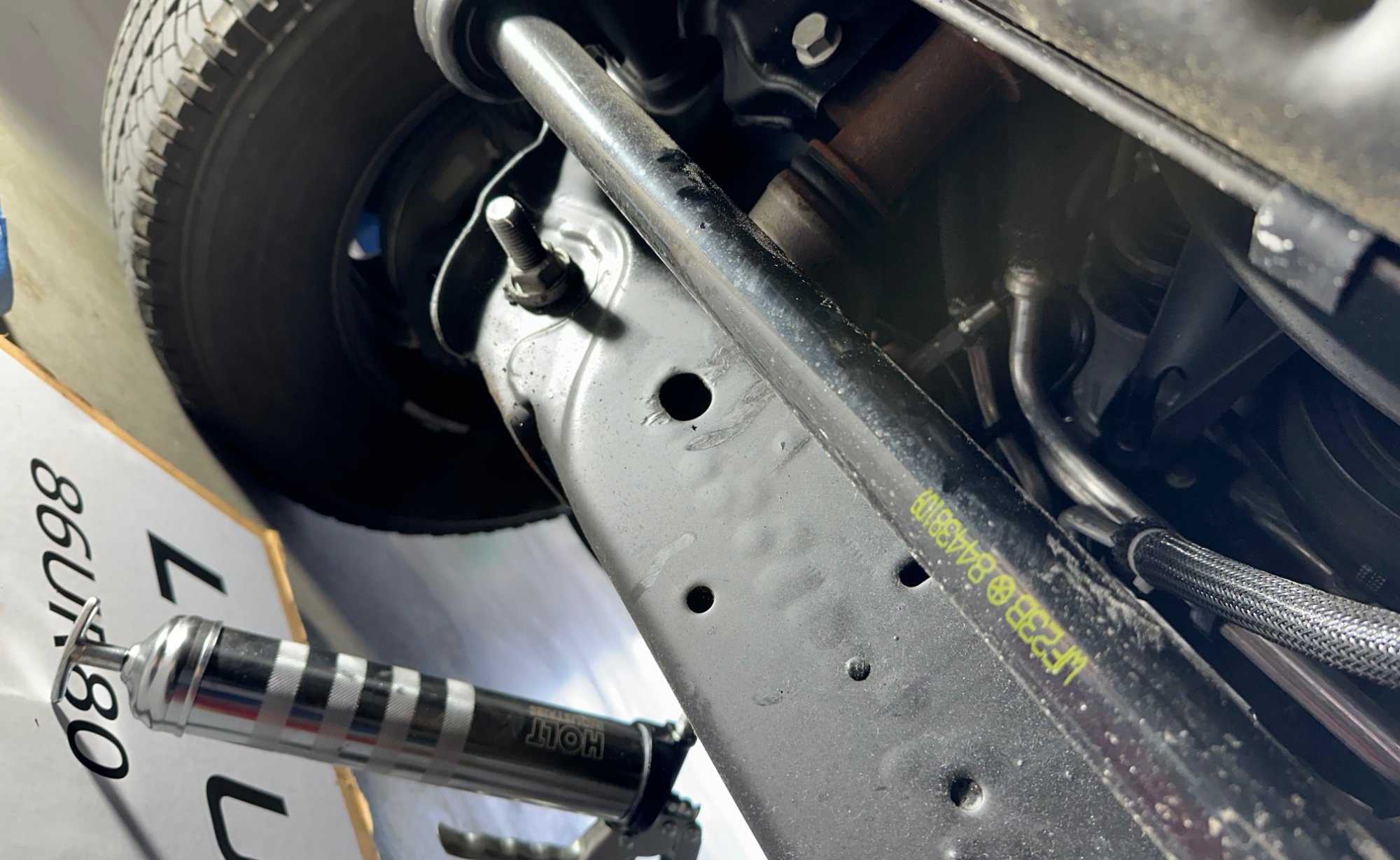

but I will end with a picture of the demon zerk. Just for fun. This one is such a pita to get to. This pic shows the only way I was able to get it. Those hoses are almost in the way.

Next time you go to do that one get an assortment of 90 degree fittings and replace it.
I dont recall the thread of the fitting, they changed them at some point because the stash I had of them from before wouldnt work and I had to buy more.
