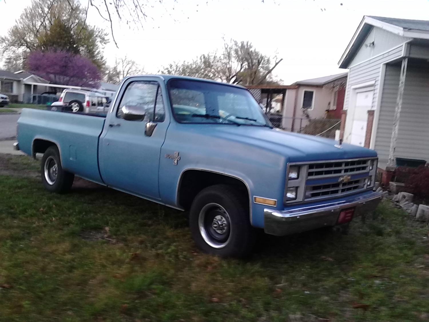

I agree with you I am done with these new cars, even some vasoline would not help. I have an old 86 Chevy truck that I payed 2500.00 for 8 years ago and I puit a new crate motor and crate tranny in it some new upolestry all for less than 3000.00 and it is like new, very dependable and has never broke down in any way shape or form and as you say, if it were to break down I could probably fix it on the side of the road and move on. it cost me 12 dollars a month for insurance. would not trade it for any new truck on the dealers lot even if it was an even swap --By the way u can just barely see the piece of crap Monte Carlo setting behind my old truck post-137219-0-26539900-1418329203_thumb.jpg
