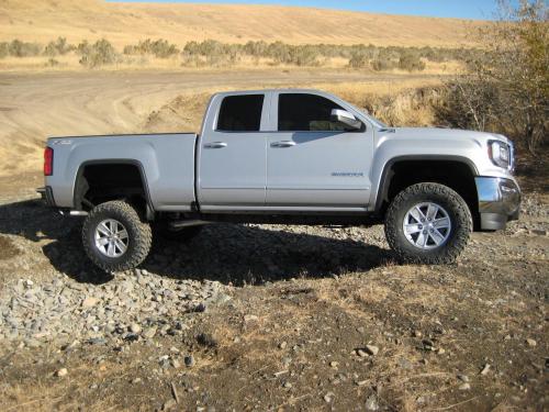

5" rc lift. Kit comes as 5" lift in front and 3.5 in rear (comes with 4.5 block but your supposed to remove stock block) I did the 5" in front and left stock block in back for a 4.5" lift in back. Kit was a pretty smooth install and rides great
Truck looks great.
If I understand what you said correctly, it means you have stacked the 4.5" block on top of the factory block. For your safety and the safety of those around you, get yourself a bigger block for the back and remove the stacked blocks.
If I have misunderstood you, roll-on!
