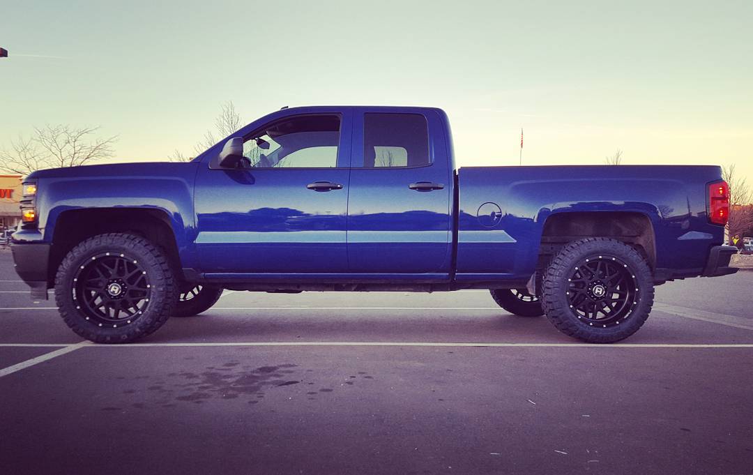

14 silverado with 2.5 rough country leveling kit with 20x10 Hostile Sprocket wheels laced with 33x12.5r20 Nitto Ridge Grapplers. I did minor plastic cutting with no rub. I was told it couldn't be done and it was easily donepost-167089-0-30851700-1483077280_thumb.jpg
Thanks for posting that up doubleg. Looks great and is exactly what I'm looking to do except hostile gauntlet in the 20x10 and some coils to level instead to upgrade the ride. Where did you trim front lower valence or did you rub in the back of the wheel well. I've got gatorback mudflaps all around and concerned it'll rub on the flap
