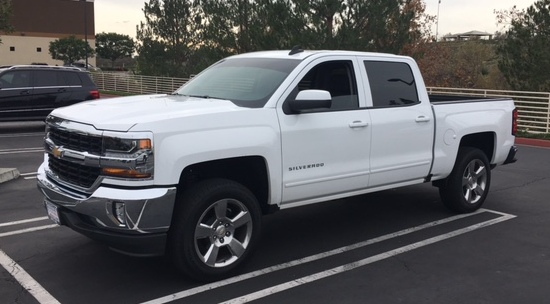

2017 z71 cc with 2.25 level and 285 65 r18 ko2s. Happy with it as I didnt want any rubbing and keep it reasonable. not bad for under 2k with level, wheels, and tires.
That's a good look. Your rims look a lot like my stocker GMC Z71 rims. And please peel that auto dealer sticker off the tailgate...that's the only debadging needed!!
Yep, that HAS to go! :thumbs:
oh yeah theyre stock gmc wheels, I liked the 18s better than the 17s that came on my truck. Dealer swapped them before i bought the truck thats why i got such a good deal. Bought the 18s for 300 OTD and sold my stockers with tires for 1k. If the weather ever stays decent ill remove that sticker. its usually the second thing i do.

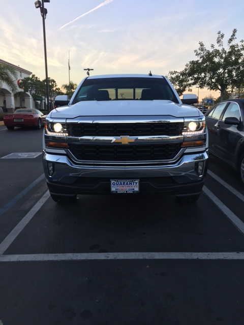

New here but have been looking around at leveling kits for a while. Just got my Ready Lift 2.25 installed so wanted to post a pic. Maybe this will help someone else make a decision. Ride is exactly same or maybe even better (I know I must be imagining that). Cost me $480 for kit and install here in Southern Cal.

Awesome looking truck. What size Tires and did you have a rear block installed?
I'm running 285/75r18. Just a 2.25" readylift leveling kit. Stock rear block.
NIce! Been looking a bit myself and ther eare just so many options... Was this Lift Kit just for the Front? You have a model #... Did the shop help you determine was size kit you needed depending on your current rake and what you were looking for: True level, Slight Rake, Slight Squat... Please post some more pics if you have them..

Shop didn't help but I didn't really ask either... I just did a quick measurement on the back and front wells a knew anything less than the 2.25 would leave me wanting. In the end it worked pretty much perfectly. I think there is a very slight rake still, which is cool with me. I don't have the kit model # handy. Here are a couple more pics (not the best quality I know).
