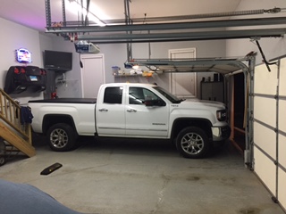

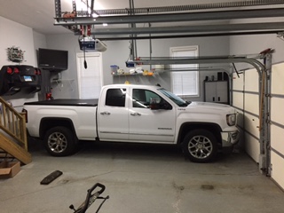

Here's a before and after of a 2.5" RC front & 2" rear block on my '16 Sierra with factory 20's.

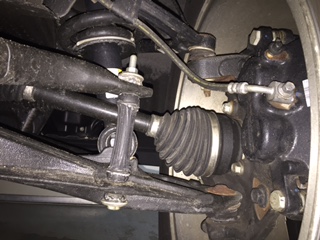

Below is a pic of my suspension and the angle of my front drive shaft at the wheel. Love the look of the raised truck, but the ride, its another question. I read back thru the last 20 pages of this specific forum, and only found one comment about the ride. Mine feels as if there is rolling resistance, as if something is holding it back. Yes, in neutral it rolls as it should but even then or under power, still feels like resistance. It's only been 2 weeks since I completed the DIY project. Any thoughts anyone? Just searching the web, a ricer forum thought someones E-brake cable might be pulling taught. Any help?
