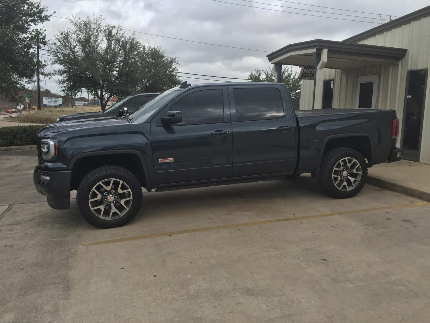

Here's a before and after of a 2.5" RC front & 2" rear block on my '16 Sierra with factory 20's.
