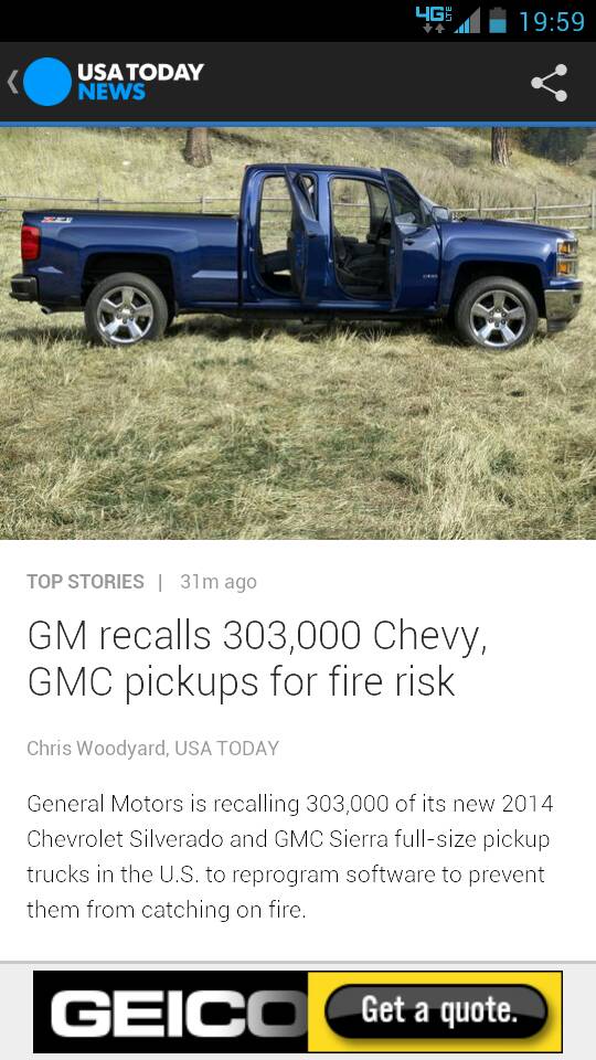

I brought mine in for the fire recall fix. I explained the LED issue and that they should work etc. When I got the truck back they basically said that the other trucks on the lot don't light up either so that means there is nothing wrong. I would like to hear the part numbers ordered or service number or something. I think it's a shame that some of us our left out of these fixes because there is no information whatsoever from GM regarding the issue. Jennifer told me in PM that she would keep me in mind for any updates on the issue but I haven't heard from her.
