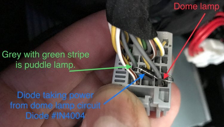

What wire did you tap into? I need to do that
I tapped the puddle lamp wire. It is the gray with green stripe on the gray BCM plug under the dash. Picture credit goes to @pgamboa

I tapped the puddle lamp wire. It is the gray with green stripe on the gray BCM plug under the dash. Picture credit goes to [mention=159655]pgamboa[/mention]
3A5A2DFD-6A30-4D66-9FBB-92D22A0C2E01.thumb.jpeg.cdc633578a23fff644172238f2f59284.jpeg.1ab585b71f8df509a60e5dba6554a7b4.jpeg
Does that mean if I’m driving down the road and I turn my dome lights on, it’ll also turn the running board lights on also?
Not if you don't jump the dome and puddle lamp with a diode.

ACTUALLY, I did this same mod on my '15 Silverado.  If you turn you interior lights ON, the Puddle Lights will also light up.
Mine don't.
