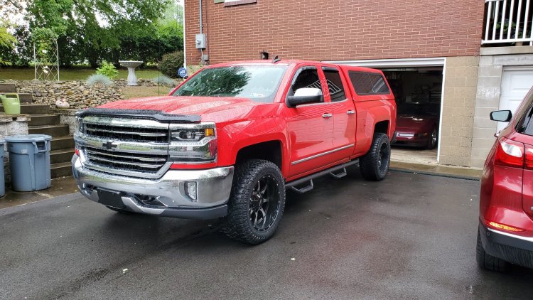

So today I installed the Zone Offroad fender plates, I debated doing this for a couple weeks and finally made my mind up, my tires didn't rub that bad but it bothered me a lot. It was really hard to get a die grinder out and make that initial cut but it's now done and I'm very happy with the results, no more rub in either direction and you can't even tell there was anything done to it. On all of the videos I've seen about doing the Norcal mod everyone just sprays a little spray paint in there and calls it a day, I bought some POR15 and put on three thick coats with a brush over all the exposed cut metal. If anyone is considering this for tire rub, go for it you'll be glad you did. The only reason I went with the Zone plates over the Rough Country plates was the directions were better in my opinion, and there was a good video on Youtube as well, they are both basically the same thing though. I'd post some pics but there isn't really anything to see lol. I will say this, there is at least 5/8 of an inch of clearance now.

Pics of your truck?

These pics are couple weeks old but in the wheelwell pic there's now at least 5/8in of clearance now.
