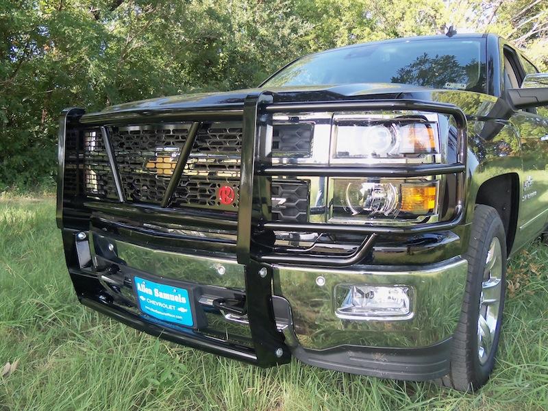

Here are the pictures I have of other brands to compare the sensor and locations of guard
Ranch Hand
Renegade
as it turns out, all i remembered was "ranch.." something something..... lol.
it was the ranch hand that i had installed. so much for paying attention to detail. i just got off the phone with the guy at the shop and he's all set to give it some adjusting as needed to get it to work. if we can't, he's got no problem sending it back and refunding the money.
