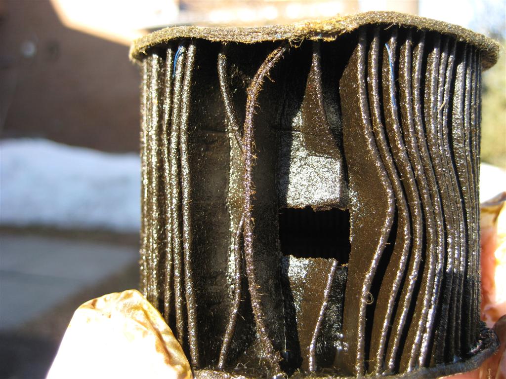

If properly manufactured, how much difference is the paper-glue-cardboard pleat end on the PF63E from the paper-glue-metal end on the PF63? I would think the glue may be an issue but the filter element paper is probably the weakest part of the filter. Of course that assumes the filters are properly made.
Any info on the reported oil filter failures on the 14/15 trucks? I wonder if these failures led to the PF63E design changes.
I cut open a used PF63E last week and didn't like what I found. The end piece wasn't bonded completely. The filter only had 5k miles on it.

Never seen a PF63 or PF63E failure here at the dealer.
The end pieces are not bonded anymore.
They're not bonded with adhesive but they're supposed to be "thermally bonded". Half of the end piece was, the other half wasn't. You could see where the bond was defective and came apart.
This is link illustrates exactly why the E-cores shouldn't be on your truck:
More pictures:
http://www.bobistheoilguy.com/forums/ubbthreads.php?ubb=showflat&Number=1806202&page=1
I have only cut 2 of the e cores open, both were loose like that. When I inquired I was told it was an assembled fit, no bonding.
