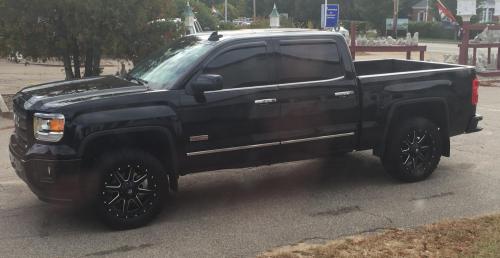

Check my album for the silver 2014...its my GFs truck and has 275/60/20 Ko2s on a 2" pro comp level... On mobile so i cant seem to post pics lol

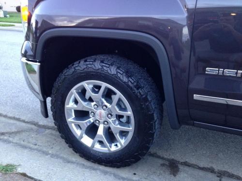

my 275/65-20s are getting installed tomorrow, ill post comparison pics afterwards. i have the RC front level kit only, hopefully i won't rub, if i do ill add the strut spacer and rear block to make it the 2.5 inch kit.

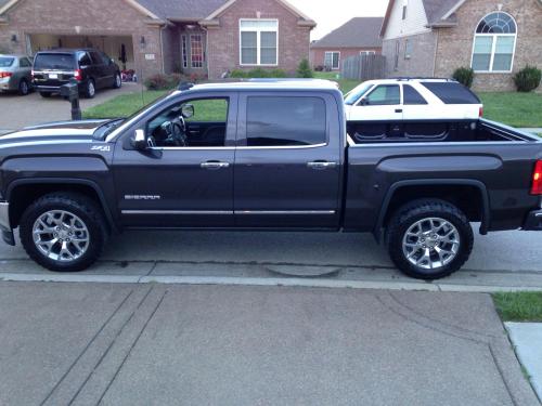

Here's mine...275/60r20 on stock suspension. I love these tires and they are wearing great! I've got 35,000+ miles on this set and they still have 10-11/32 tread depth left. Hoping to get around 60,000+ out of this set before having to buy new ones which won't take me long since I drive 3500-4000 miles a month!
