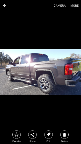

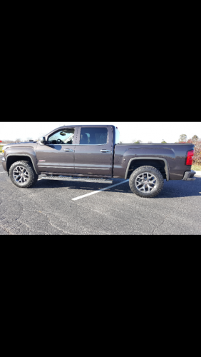

My truck has 275-60-20 BFG KO2s on it.
Sweet looking ride man!
What's the offset and width of your wheels? Any lift/level/torsion bar crank? Any rubbing? I have a black 2500 Denli and I was looking at a similar look. It's my first 2500 and my first Denali AND only 2 weeks old so I'm still scared to touch it/mess anything up on it by modifying anything lol would def love a stock quality ride minimal addition to height (if any at all) and some aggressive looking tires/wheels.
The wheels are 20x9 +20 offset. No rubbing at all. I'm actually gonna get a wider tire here pretty soon, thinking 295 55. It's just a 2" level up front, no rear blocks. Ya I love the lifted truck look but I felt the same way I didn't wanna get too crazy with my new truck and I like the smooth ride. I'm prob gonna trade up to a 2500 here soon.

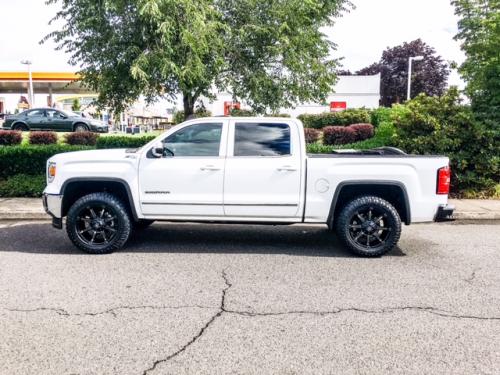

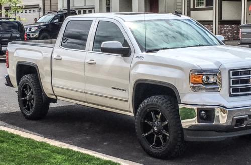

275/60/20 Duratracs
I don't know how long you have had these tires on but do you have any reports on ride quality and fuel economy?
Thanks
Thanks
I have 19000 miles right now on my truck, I put them on at 6500 miles. I LOVE these tires. Ride quality is better than stock, I only say that because I put Bilstein 5100s on the truck to give me the 2" level lift. When I did that is when I put the new tires and wheels on. The bilsteins and tires are way better than the stock Rancho with ride quality and handling. I lost about 2 mpg around town but also because I lifted the truck. I can only get about 19-20 on freeway where I use to get 22 ish.
we had a huge snow storm this winter in oregon, We had over 8 inches of snow and these were exceptional. It went through it like nothing. I will not buy another tire after experiencing these.

Is this with a 2" in the front only?
Yep! Bilstein 5100 shocks give you 2" of lift even though it advertises only 1.8" Nothing done with back except changing to bilstein rear shocks (no lift).
