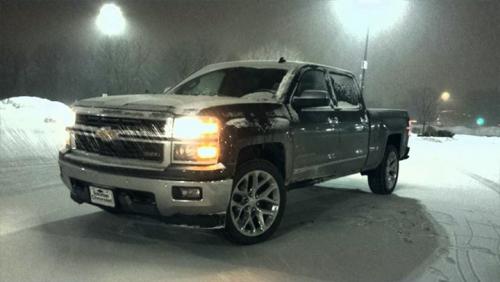

Anyone got any pics of my wheels (keep in mind, they are) 22's wrapped in 33's?

These are Nitto 420s street tires but they are 33s
Thanks for that. Not quite the aggressive look I'm going for. Really making me consider 18" wheels instead...
