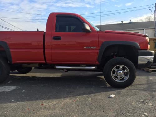

I picked up a STOCK 2006 2500HD single cab 8ft bed for work/new project.

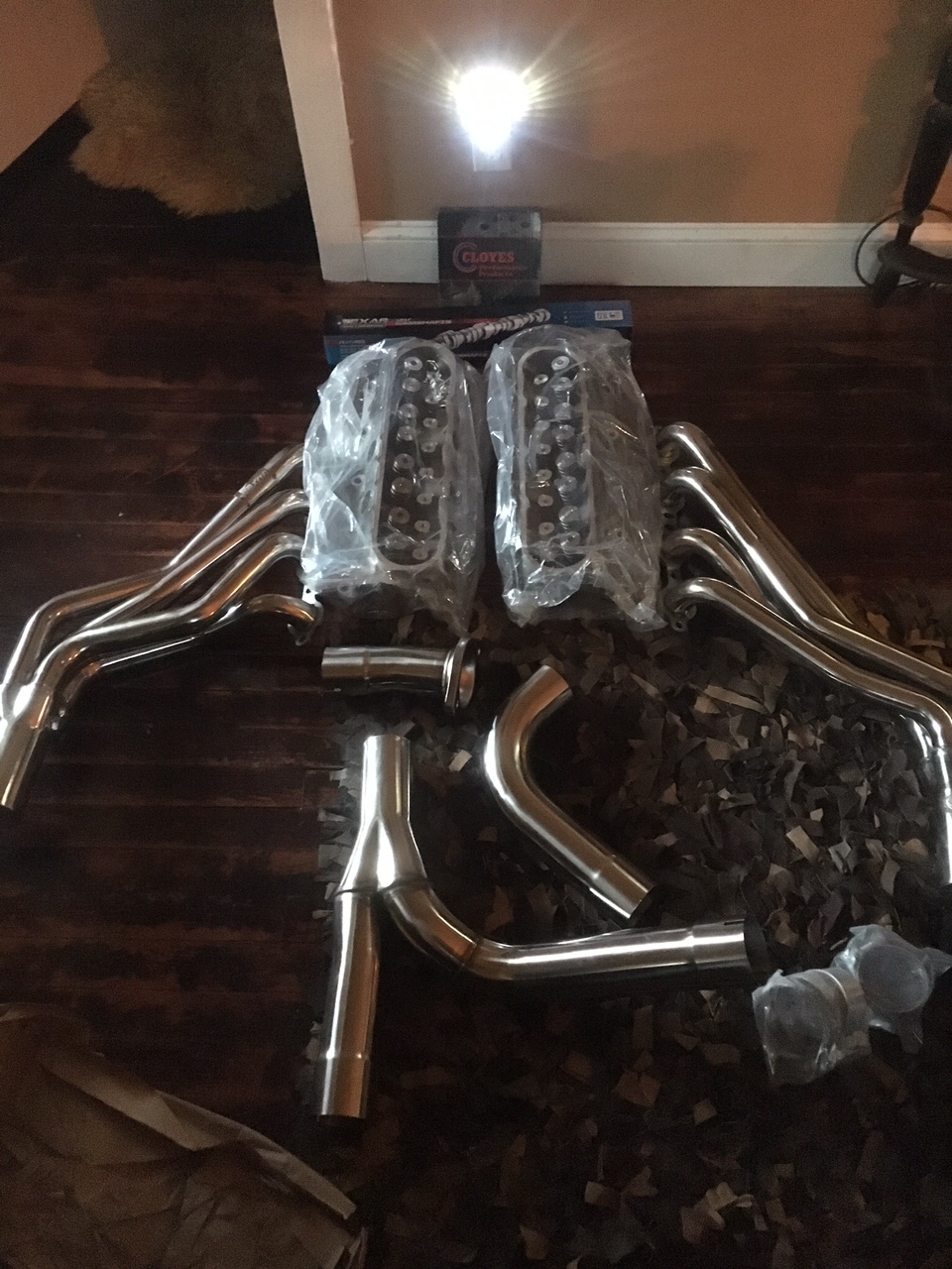

PARTS:
LS3 Precision Race CNC Ported Heads
Upgraded GM Valves
.660 PRC/PAC dual spring kit with titanium retainers all milled to 229/236 Cam
Texas Speed 229/236, .629/.615, 111LSA, Three bolt core Cam
7.40 Hardened Chromoly Pushrods
LS6 Race billet single roller timing set, Z06 chain, 3 keyway sprocket, and 3 bolt cam
Forged Wysco Pistons
LS6 Ported oil pump
ALL NEW SEALS AND GASKETS obviously
YANK Pro 3200 Stall converter for 4L80E
Custom Performance 1 3/4" Long tube headers
3" Performance Y pipe
K&N Cold Air
Upgraded Trans cooler, and 3.73 gears.
Then Custom tune and Dyno

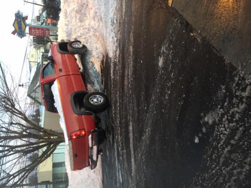

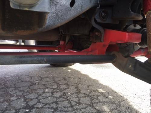

Anyways, I will have all my parts i need to finish by 2/10.2016 she will be on the dyno 2 days after i get all the shit in. let me know what you guys think of the project and stay tuned, this "work" truck will knock your socks off. Cant upload pictures too big, pics are of the truck after Lift was done, more pics/Video of truck after work is done.
