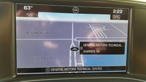

After my successful android auto update today at the dealer it now screwed up my factory navigation. It is now stuck on the screen in the pic I uploaded and there is no GPS signal at all WTF ? I have to go back to the dealer on friday to try and get it fixed. Anyone here a tech or have any idea what the heck happened ?
Looks like the Nav thinks it went 'home' to the GM tech centre.
Top RH corner is showing it's not getting a gps signal. (red line thru 'gps' lettering)
Maybe disconnect battery or pull fuse to force it to reboot.
