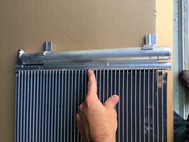

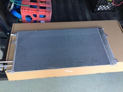

Anyway, as I said I lucked out today and caught one in stock. From looking at it, it's possible that at least some manuf are trying to address one, maybe more of the issues. This particular piece is a "ToughOne" brand and as you can see from the pics, the end caps and the filter/dryer tube have substantially beefier connections to the core itself. I'm pointing to the location where my leak was on the OE piece with a swedged tube instead of a weld. In fact the whole thing does, in fact, appear "tougher". We shall see.
I don't know on the PAG viscosity but you can look it up if you identify your AC compressor pretty easily.
Install went smoothly. About 2 hours, with time for radiator cleaning (necessary!) and a beer. All and all not too bad. Only lost one bolt. I'll consider it marginally necessary at this point. Hopefully I can get it charged up tomorrow.
One thing I did notice was that the "ToughOne" condenser, though it definitely appears tougher than stock, uses a two piece, rather tiny desiccant and filter. It comes pre-installed, which is nice, but I'm not sure where a replacement would be easily sourced. The stocker will not fit without some SERIOUS poking and cursing, which I opted not to do and I went with the pre-installed pieces.

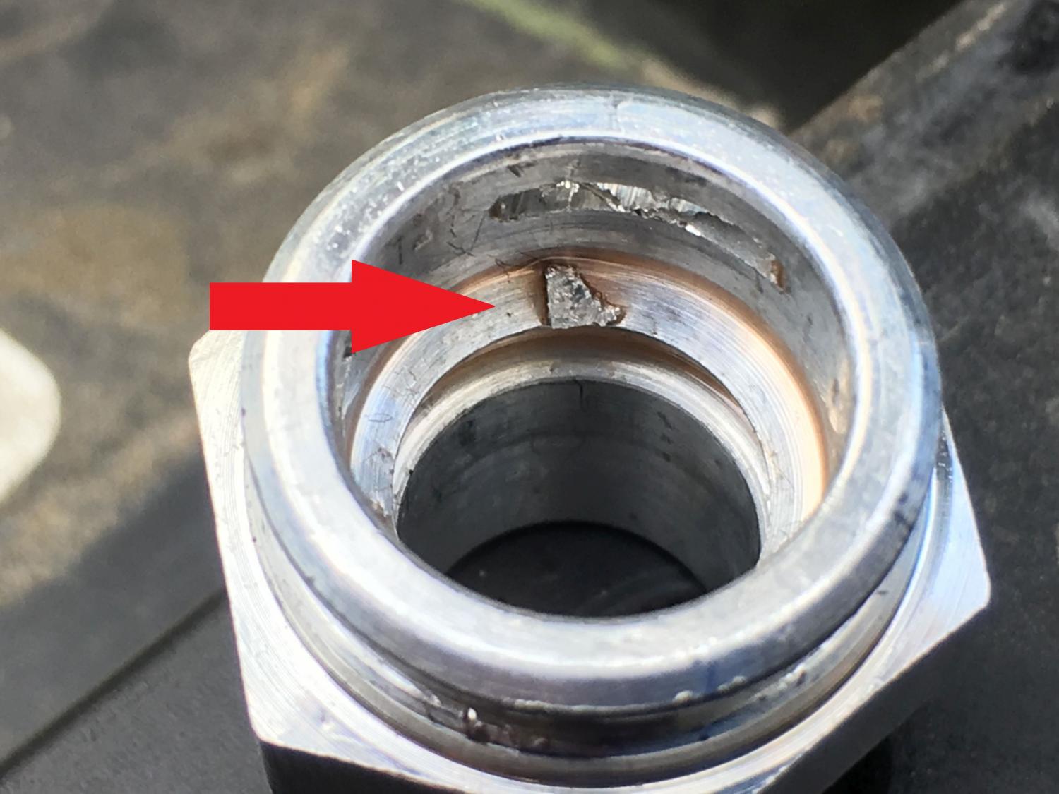

I hold fitting up (still has old o-ring in it) and look through it. "Huh...that's interesting..." I hand to my buddy and he says "What? What do you see?" I says "You tell me?"...."Huh...it's kinda...I dunno, not quite round maybe?" Yep. O-ring's ID isn't perfectly concentric.
Grab the pick and work the old o-ring out, and this is what I see:
Stupid little *^^%#$%^ aluminum chip/burr that had nestled itself under the o-ring. And not only that, but it lasted there through all of our poking, prodding, o-ring swapping, etc. Tiny little thing, but juuuuust enough to let the fluid POUR.
So, moral of the story is I have what is possibly the world's worst luck, and check your fittings :/
Oh, and put it all back together, everything works great.
