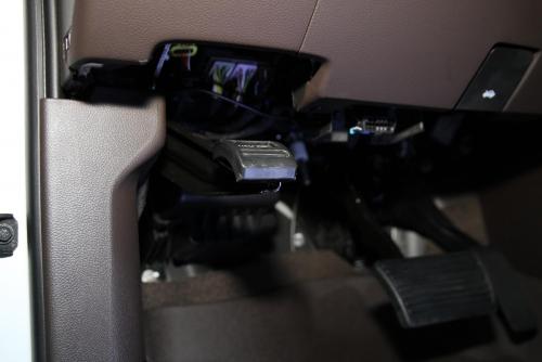

Then you'll look under your dash above your gas pedal. You'll see a bunch of small power blocks inserted into a larger one.
You want to locate the BROWN one.
At the top you see a release latch. Go ahead and push it in and pull the small BROWN electrical block out of the larger one.
Twist it around so it's oriented with the release latch up.

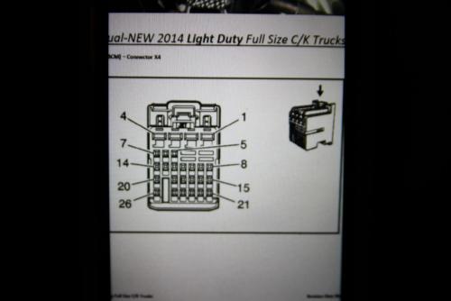

Using the diagram in the picture I've attached, locate pin/cable slot #10. It's obviously 2 slots over from #8 that's marked on the diagram. Insert one end of the electrical diode down into that #10 slot. If needed use a needle nose pliers. The diode pins are pretty bendable so just make sure you get some of it down into the #10 slot.
Then go down to the bottom (last row away from the release latch and go to slot #22 (clearly one over from the #21 that's marked in the diagram).
Push the other end of the diode down into the #22 slot.
Once you have them both in the #10 slot and the #22 slot, you've made a jumper "bridge" between the two.
Gently twist the BROWN electrical cube back so it's oriented and push it back into it's motherboard. It will click back in.
Insert key in your ignition and test it out.
You're FOG LIGHTS should automatically be ON if your low beam headlights are ON.
When your low beam headlights are OFF, the fog lights will also be OFF.
You can now just leave the dash mounted headlight selector in AUTO and your low beams and your fog lights will both automatically come on each and every time your headlights come on, and go off when the headlights go off.
All done.
All done.
