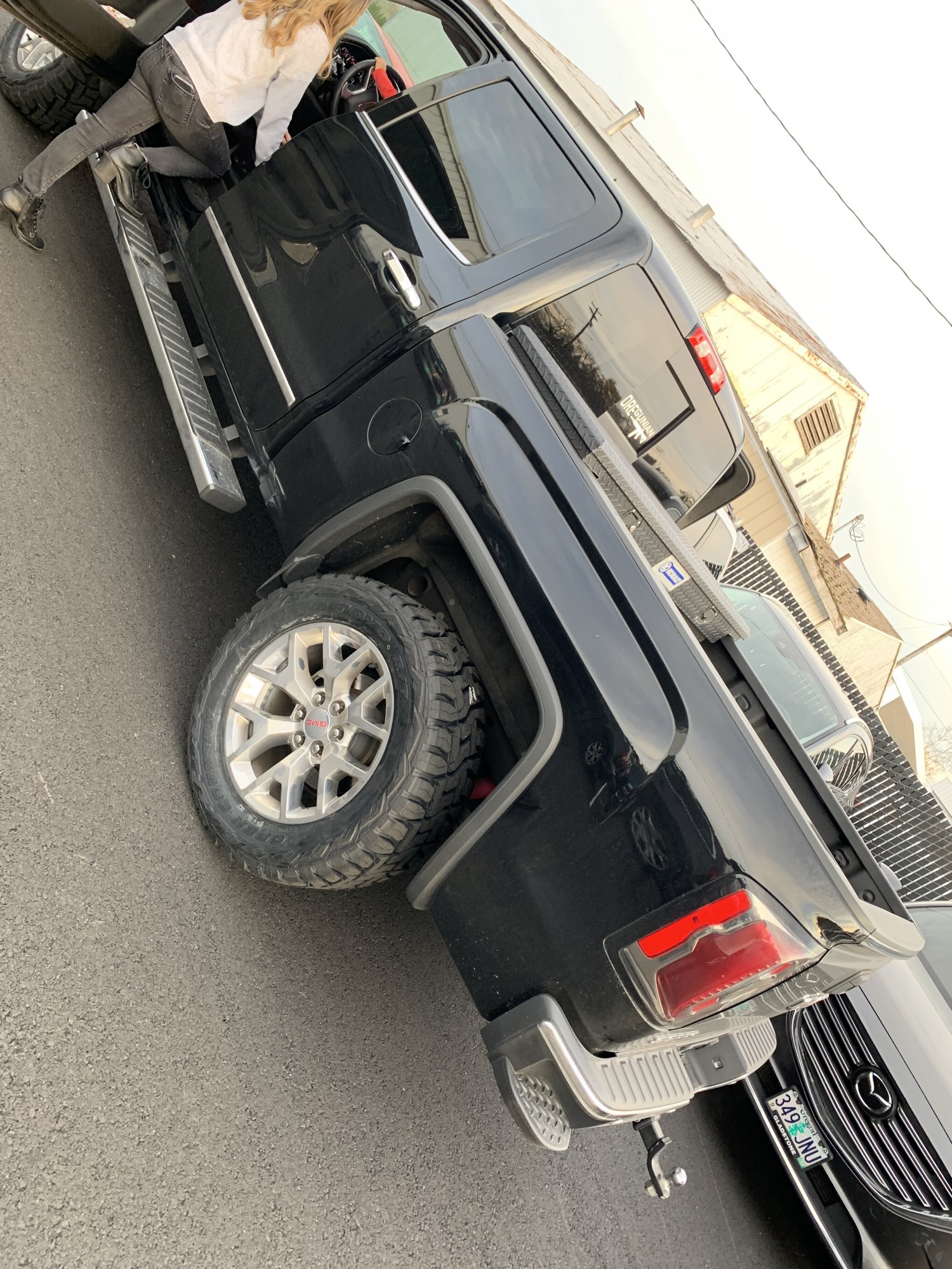

Just in case this helps anyone who is wondering. Installed 305/55/R20 Toyo open country RT’s on the factory GMC 20’s, with a 2” rough country level. Only rub I get is at full lock in reverse, but you almost have to try and make it rub.
truck is a 2018 GMC Sierra 1500 SLT.
