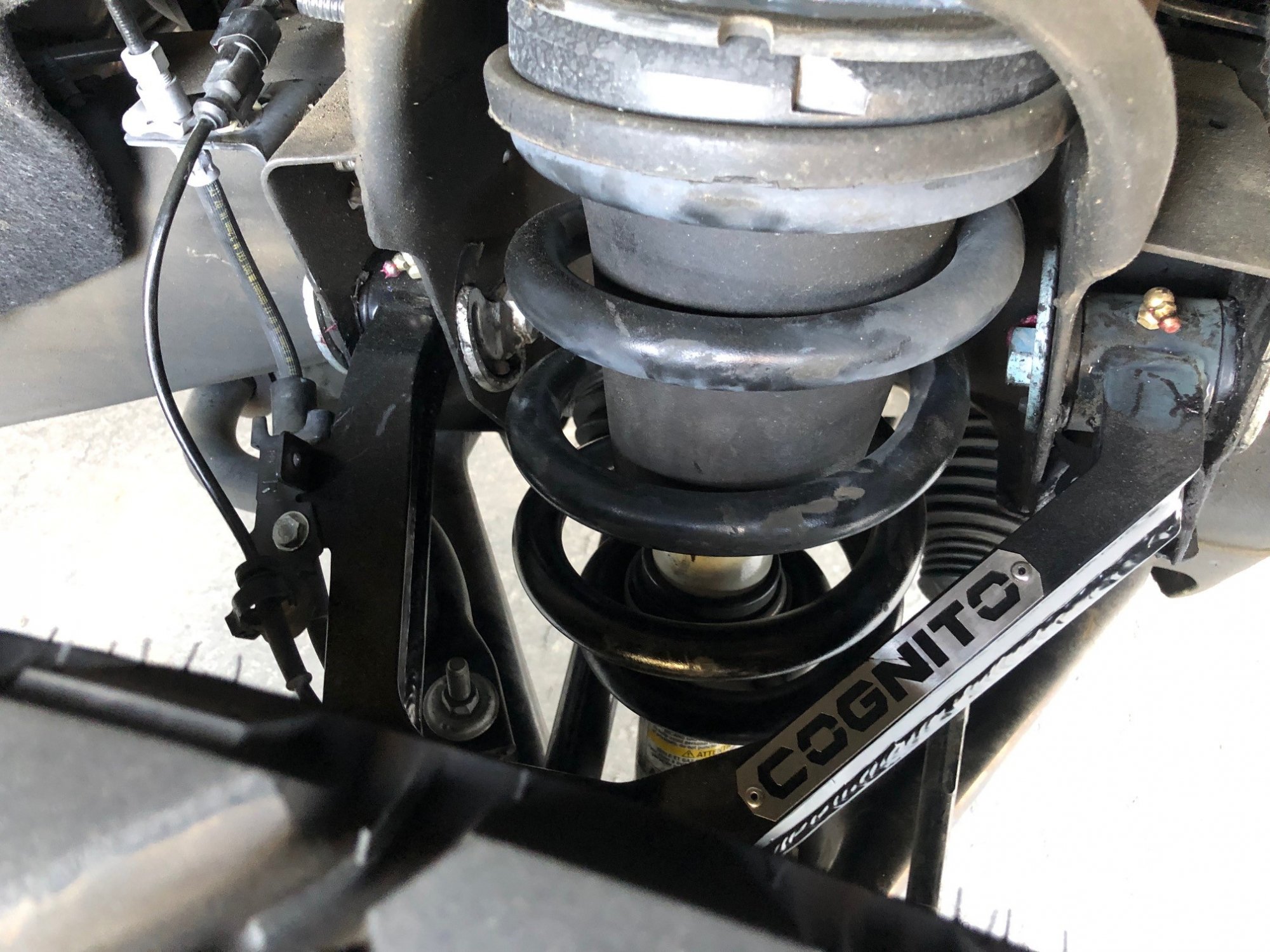

Installed the cognitos today.
where did you end up getting them? price??
did you have to "chase" the knuckle for the ball joint stud as mentioned in the install instructions?
how about the frame pocket bump stop, did you cut that off?
thanks
thanks
On mine I had to chase the knuckle and didn’t cut the bump stop. Just removed the rubber piece off it.
thanks
If you wait you can get them on ebay with the 10-15% off discount codes.  I think it's around $450 with the discount.

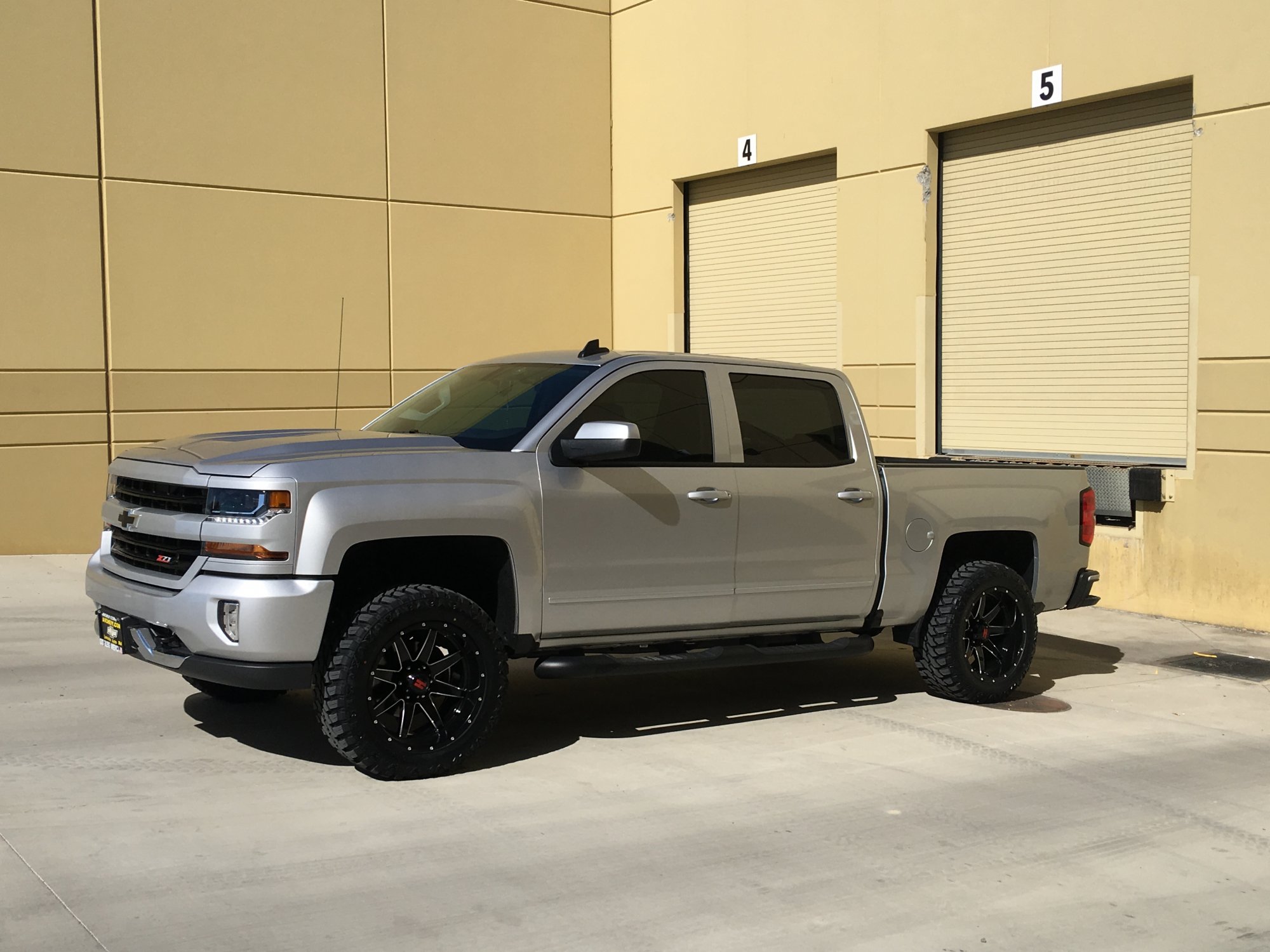

On 11/3/2018 at 3:32 PM, 2k10CrewCab said:
Yea I was running stock 18s with 265/65 tires no rubbing issues. I just went to a 20x10 -24 with 33x12.5 tires and no rubbing issues either with this new setup.
You were running the 2.25 lift with 33 / 12.5”?  Any NorCal mod or trimming needed?
Also, for those installing the ReadyLIFT UCAs, did you have any issues with the bearing spinning during UCA install since it doesn’t have a an Allen key to prevent spinning?
I have a 2.5” leveling kit. I had to trim the plastic on the back of the wheel well and zip tie the liner back.
